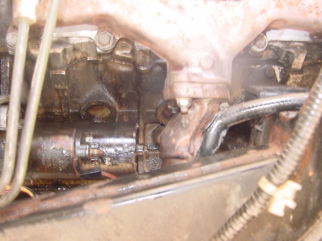

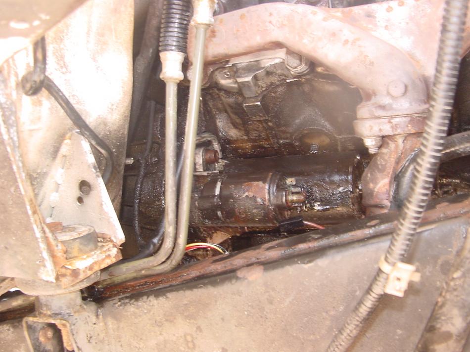

On my 97, you could hold your hand by the y-pipe to exhaust manifold area and feel the pressure hitting your hand from the exhaust leak with it running.
My advice with one that old (same boat I was in), be perpared to change all the studs (6) at the y pipe, also get gaskets for both sides. Also buy the exhaust manifold gaskets and if your bolt heads are not pristine, buy new manifiold mounting bolts. When I did mine, they told me most people do NOT use the original style locking devices because they are a PITA, use lockwashers instead.
Most likely some of the studs will break at the y-pipe. If that happens, unbolt the exhaust manifold and remove it. It is much easier to get the broken studs out with the manifold removed and on a workbench then trying to do it on the vehicle.

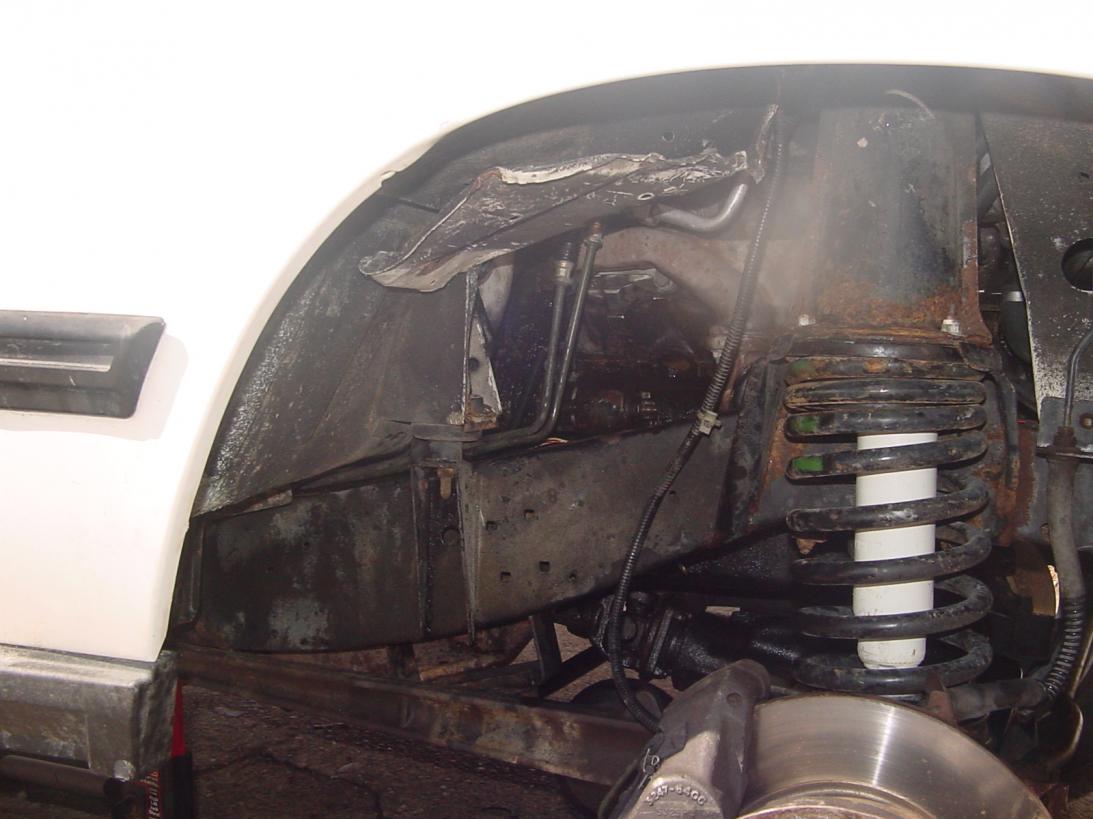

There is also a real simple way to gain improved access to the y-pipe nuts. I removed the front wheel and sat in the wheel well area using a set of aviation snips, I cut the inner fender in such a way as to fold it out of the way to allow access. See Pics. You can carefully bend the fender out of the way, upon completion bend it back.
If you prefer to maintain the "***-Built Configuration" of your classic piece of English Engineering, then by all means, don't you dare cut it up like that. If you want to gain vastly improved access for repairs, have at it.
Also remove the Windsheild wiper reservoir for even better access, especially to the manifold bolts. Be creative.
Redneck Engineering.

Thanks Dan. I was looking at that splash shield the other night when I was tightening /checking the bolts. Not sure I want to cut it though...
