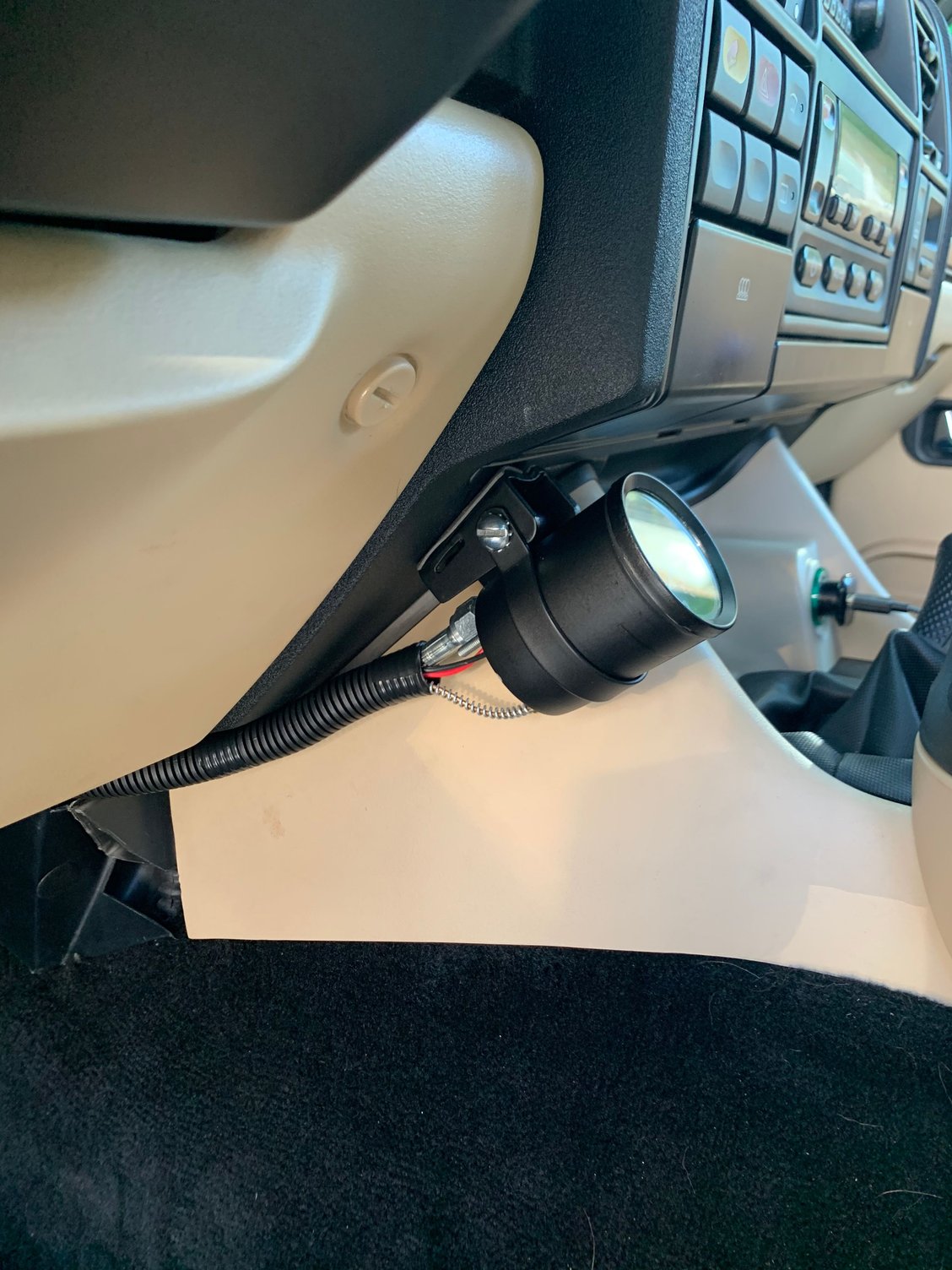

Kicking off another little project soon to install one of these just above the t-case shifter.

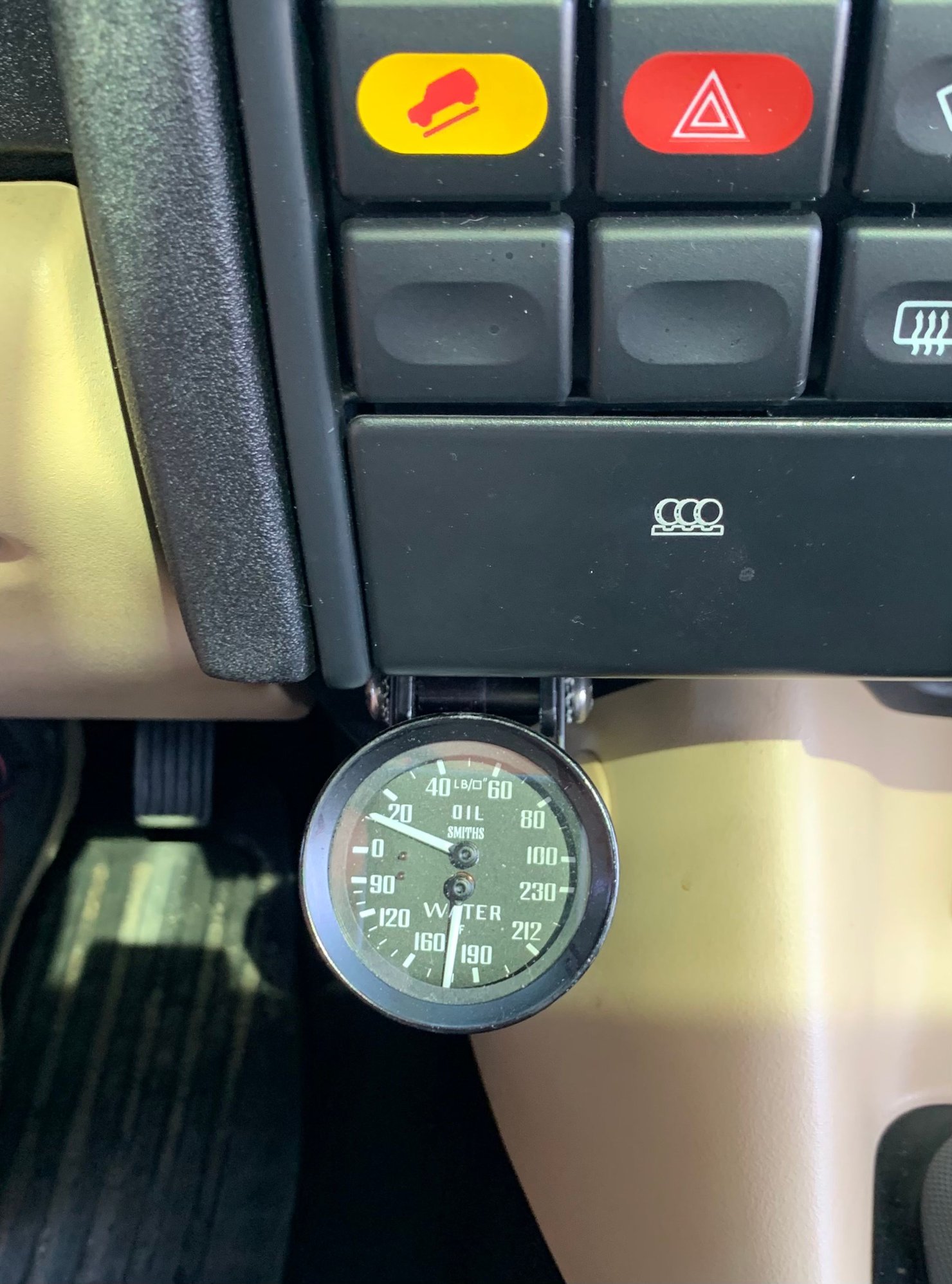

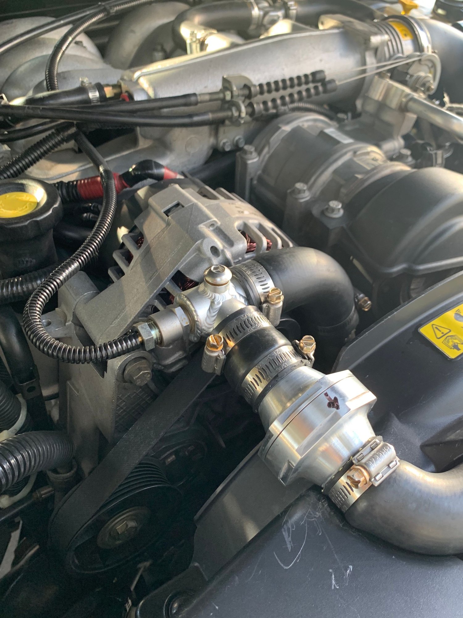

This worked out pretty nice. Not cheap, but nice...
