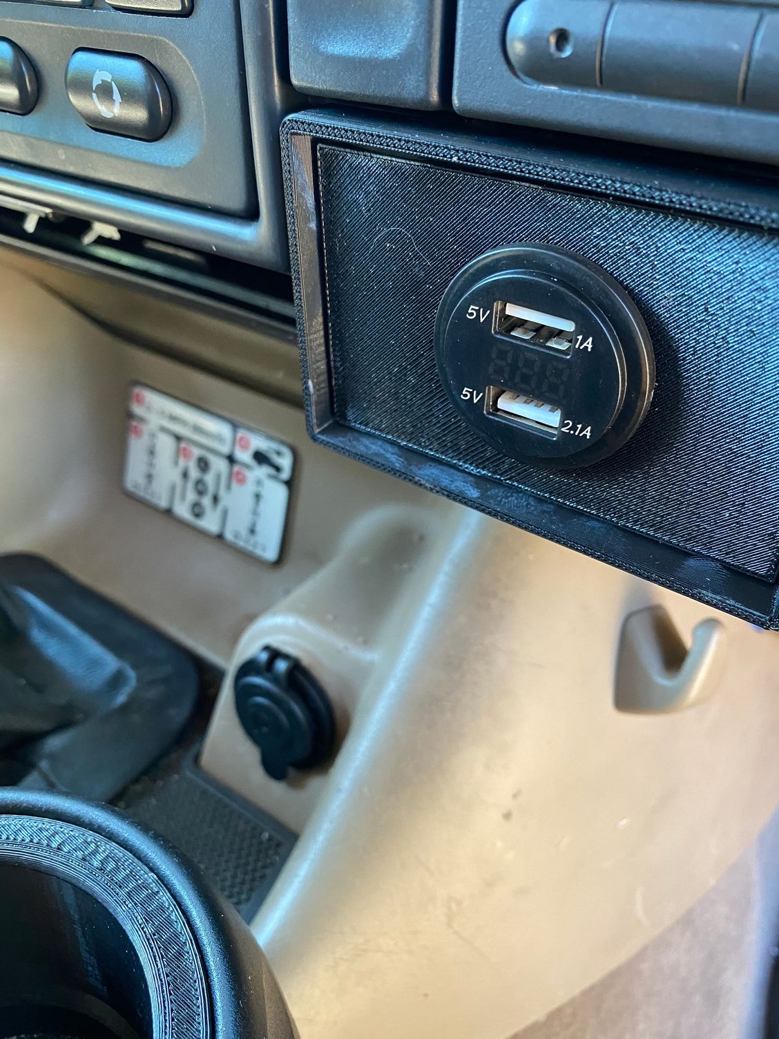

This is what I'm talking about. They come in many different colors, types, charging AMP's, styles. Some people swear by keeping their LR 100% OEM and that's fine, but I prefer small upgrades and ditching the cigarette lighter port for something like this = upgrade in my book.

The first thing I would do is check to make sure a fuse isn’t blown. That outlet is wired up on the same circuit as your review mirror, so if that’s not working either its an easy check. This happened to me recently because a poor quality accessory was plugged in and came apart in the outlet and shorted it out. At any rate I also recently replaced the outlet in my truck (it was very loose) and at the same time replaced the ash tray with 2 USB charger ports (with an integrated voltmeter, which is kind of nice). I agree with the philosophy of Best4x4, if I can make small upgrades to bring my truck in to the modern world I do.
To get at the outlet and install the new one you need to partially disassemble the center console, not entirely though, just enough to get you hand up behind there. I think the terminals will just plug right in to the new one, just mind the polarity (positive/negative).

I kept a cigarette lighter there so it looks like stock but then put a 2 usb port into the ashtray or coin thing, whichever one is on the driver side. I drilled out the stock one vs 3d printing one, however that has it's own difficulties of brittle plastic and large drill bits that tend to grab...lots of filing was done.
Hardest part about pulling the center console is the shifter ****, just pull inline with it and it will come but if it's never been done it can be a real pain...I can't remember a guide but I think there is one. Pull the rubber mat and there are screws underneath the shifter bezel I believe. The sides have a few and in the cubby. Be very careful with the window switch panel, that is a delicate piece. Sorry for rambling, it's been a while since I've had mine apart but go slow and look everywhere for screws and don't force anything and you'll be alright.
