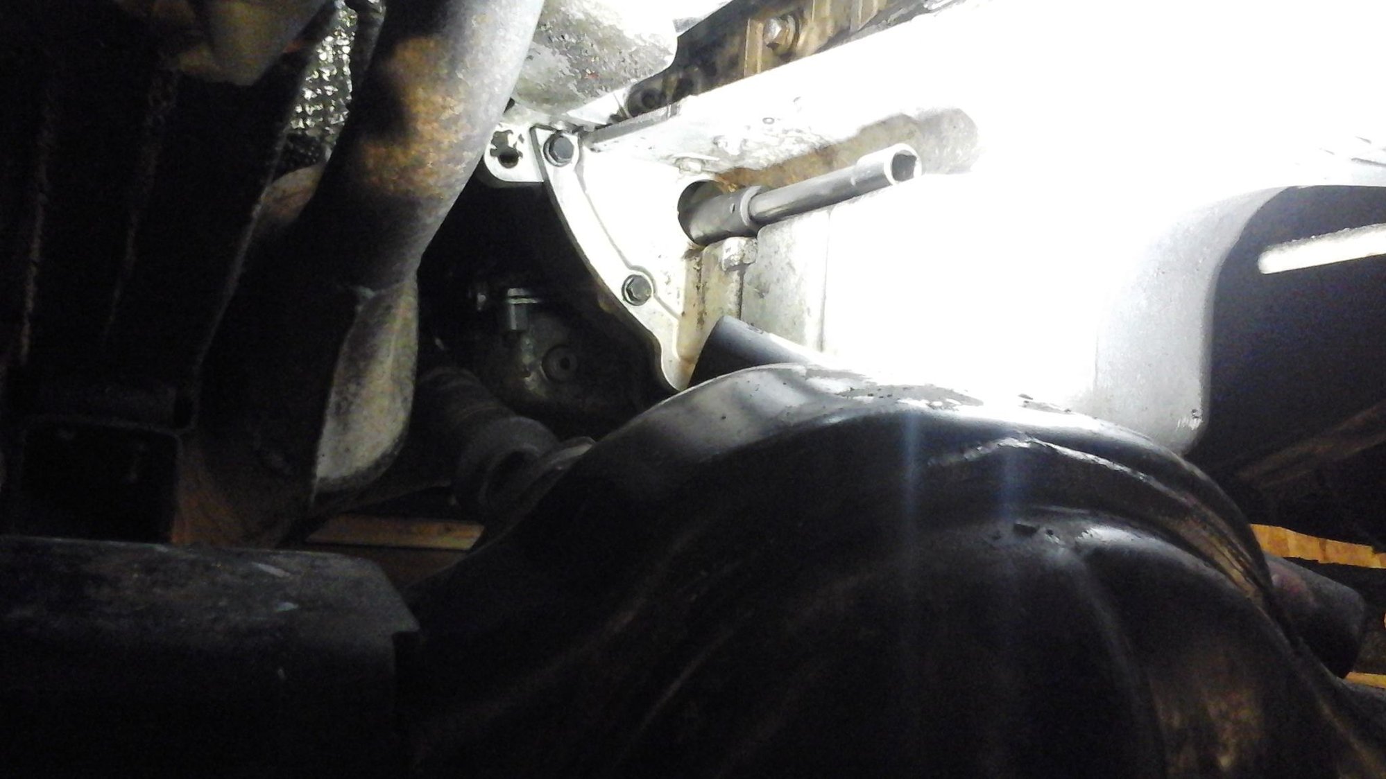

Just remove rubber plug that covers torque convertor bolts and slide a socket/extension through the hole into hole in flywheel. This will stop the crank from turning.
Then rotate crank counterclockwise until it stops turning and remove crank bolt. A lot safer than the option you're suggesting.
But, if you are he** bent on your way, fuse 14 or Relay 4 in drivers compartment fuse box.

Thanks for the tip. I did the breaker bar on frame method many years ago with a Isuzu Trooper. Worked and was kinda exciting, made lots of noise. I had my reservations this time. Thanks again.
