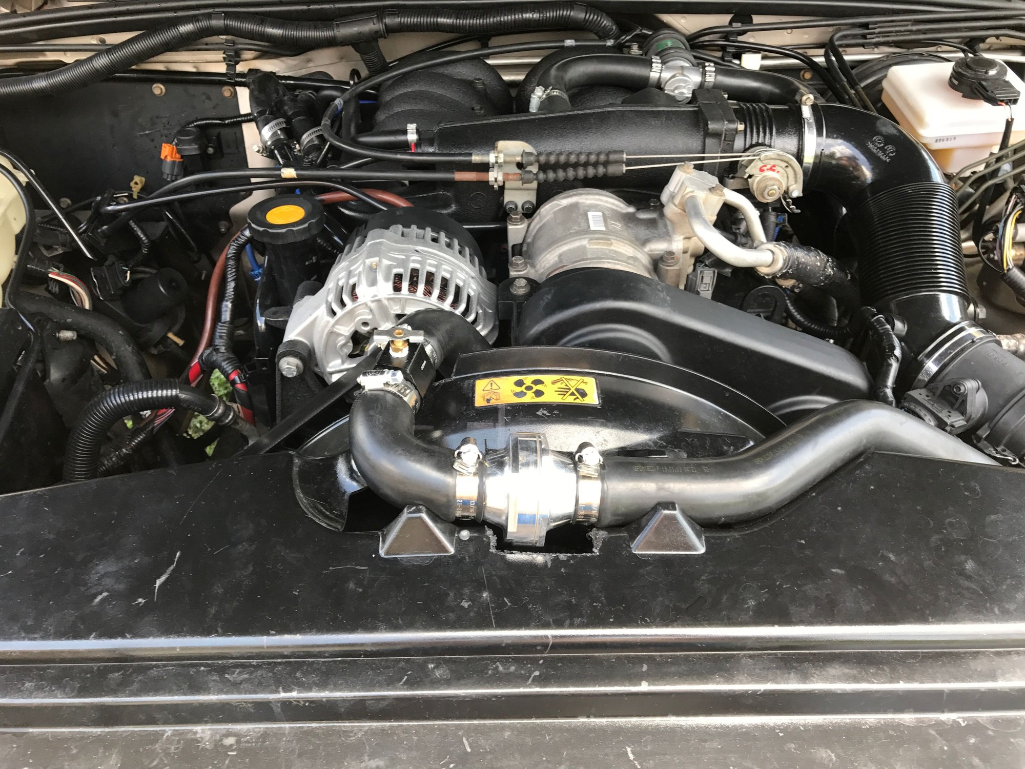

My inline mod
Old Jul 24, 2017 | 02:14 AM
  #48
chubbs878's Avatar
Posts: 1,387
Likes: 111
From: Dallas, TX
Originally Posted by Luckyjayb
My inline mod
Way to go! Just in time for the Southern Heat. It's already up to 100 here in Dallas
