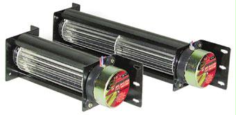

if you pick a spot with a tight fit and heat is a concern, stinger makes a great low profile amp fan (they are long in different lengths 8" should be fine)this will keep it cool if not ventilated.
