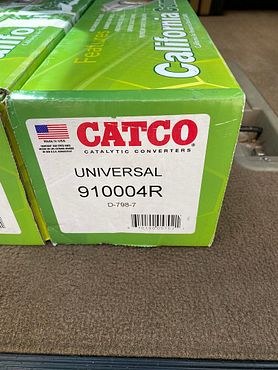

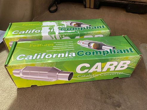

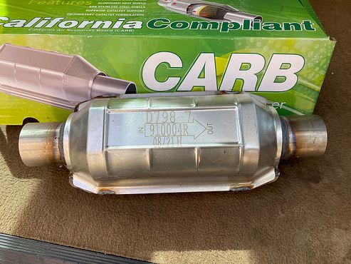

After some review and discussions with some of the vendors and shops, appears all the CARB certified AM cats are very similar, so opted for these. Getting them installed today. Hope this resolves the CEL (the Land Rover dealer said the cats were bad. I tried Catalytic Converter fuel cleaners and didn't work - after two drive cycles, the CEL came on both times after the 3rd cycle sequence.
I ordered them online from Autozone. $320 each plus tax. FedEx overnight shipping, no cost.

Yep. Retained the original CATs as well as the boxes the CARB EO compliant CATs came in for documentation. Quite the racket dealing with all this in Cali.

Does the passenger side cat not touch the frame? The factory one there is more flat. Thats looks like a tight fit.
Old Mar 8, 2022 | 09:09 PM
Hans L's Avatar
Joined: Jun 2013
Posts: 43
Likes: 8
From: San Diego, CA
It's tight but about the same clearance as before ~ 5/8 to 3/4" gap. These AM CATs are noticeably smaller. The heat shield is against the frame as well, though it may have made more sense to have the heat shield on the drive shaft side. With that, I was worried as well that it may not fit when I dropped it off. They did a nice job fabricating SS pipes with bends to accommodate the original Y-pipe routing.
