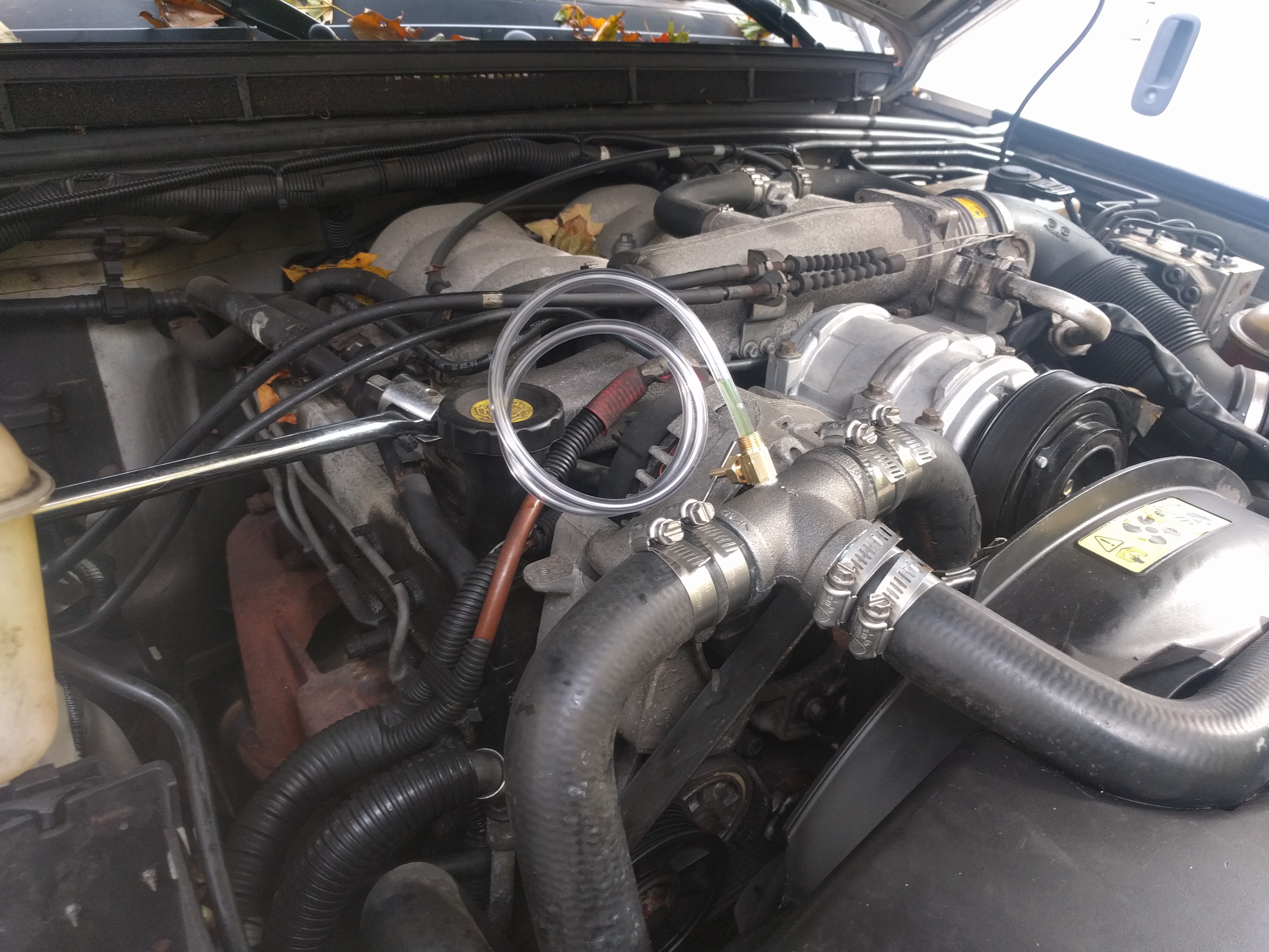

Originally Posted by jomandm
I got the idea from a few others on this forum. It is 1" dia black steel tee with threaded black steel nipples. 1x 1" Black Pipe Tee
3x 1" dia Black Pipe
The valve I used is in the compressor section at Home Depot. You will need to tap and drill for the valve.
Powermate 1/4 in. NPT Tank Drain Valve 072-0006RP at The Home Depot - Mobile
Hi Jomandm
Do you remember what size tap u used?
Thanks
Micko
Old Oct 25, 2016 | 02:47 PM
d.a.r.y.l's Avatar
Joined: May 2016
Posts: 119
The drill size for 1/4"npt is 7/16". Be careful how far in that you run the tap. They are tapered and if you run it in too deep it won't get tight. I know there is a joke here somewhere. D*

Copper T-fitting from Lowes - bolt & washer with a butterfly nut. No leaks and peace of mind

Ok Jomandm here is my effort.
Works well so far
Attached Thumbnails Bleeder Screw for Radiator T-hose fitting-img_20161029_130824.jpg
