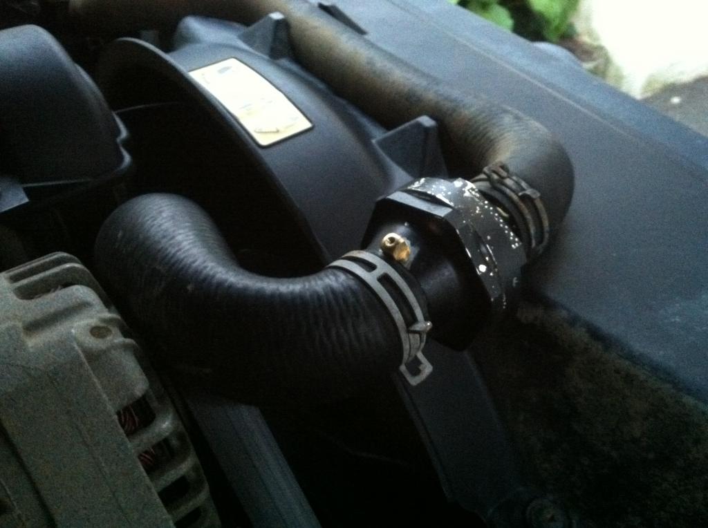

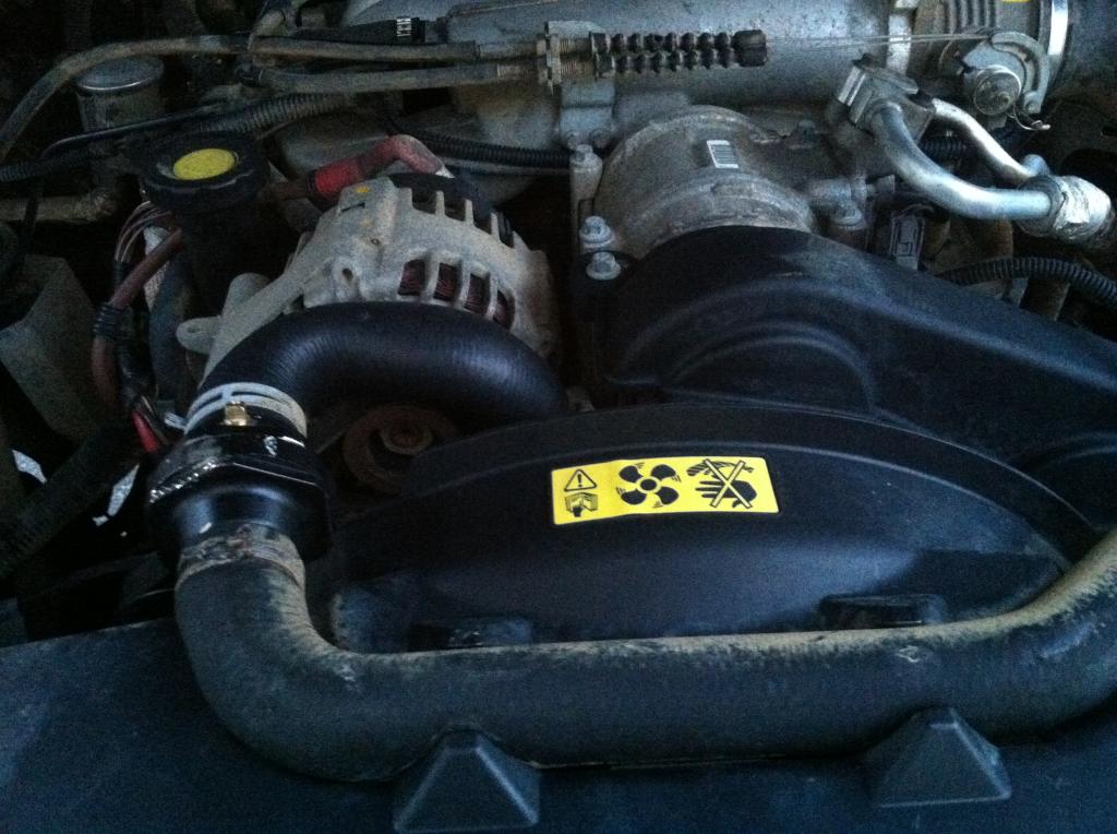

Got it sorted out today... I drilled the Mezire thermo housing for a 1/8" NPT plug and cut a small groove down the threads to make a bleeder out of it. Worked out great.

Smart! Glad you got it worked out.
