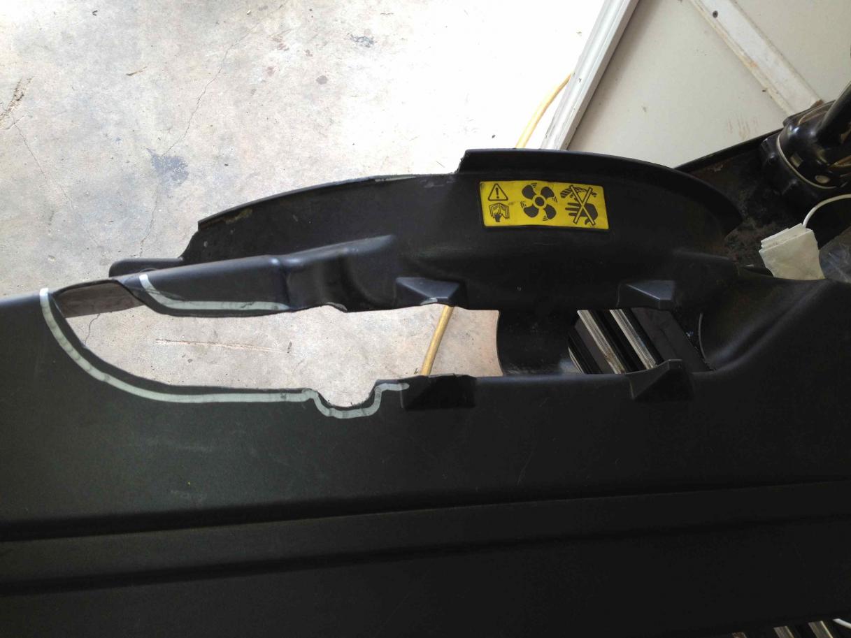

So, I followed Josh's writeup until the top part of the mod. After looking at the other photos here, I was contemplating the leftovers from this job, and came up with the following:
The hose that used to connect the lower radiator to the thermostat has a U in it. With a little modification with a razor knife, it will connect from one end of T-stat housing to the upper radiator hose.
The hose that used to connect the water pump to the thermostat has a shape that allows it to feed from the pump to the glowshift sender. The other end of the U feeds right to the other side of the glowshift sender.
What this accomplishes is the hoses are NOT BENT OUT OF FORM and will allow them to do their jobs without leaking.
Hopefully it helps someone.
See pictures below.
