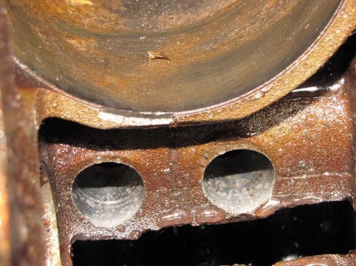

Cylinder liners cannot drop in a D2 due to the machined lip at bottom of the cylinder. The cylinder wall can crack behind the liner and cause coolant loss and pressurization of the system. Bring it home take it apart so you can see what really happened.

Seriously? I really dont care what you feel like as it does not alter reality. When you have some free time drop your oil pan and look up from underneath and you will see on two opposing sides of the cylinder bore the liner is inset flush to a lip. On the d1 there is no lip and in a overheat situation the liner could actually drop down into the bottom of the engine. Here is a cross section of the cylinder bore with liner removed. Notice around the bottom there is a lip the thickness of the liner, the liner can not get past that. The slots are the coolant channels, cracks can form there and casue headgasket failure like symptoms.
Here is another example in car. The lip is broke away revealing the edge of the liner.
