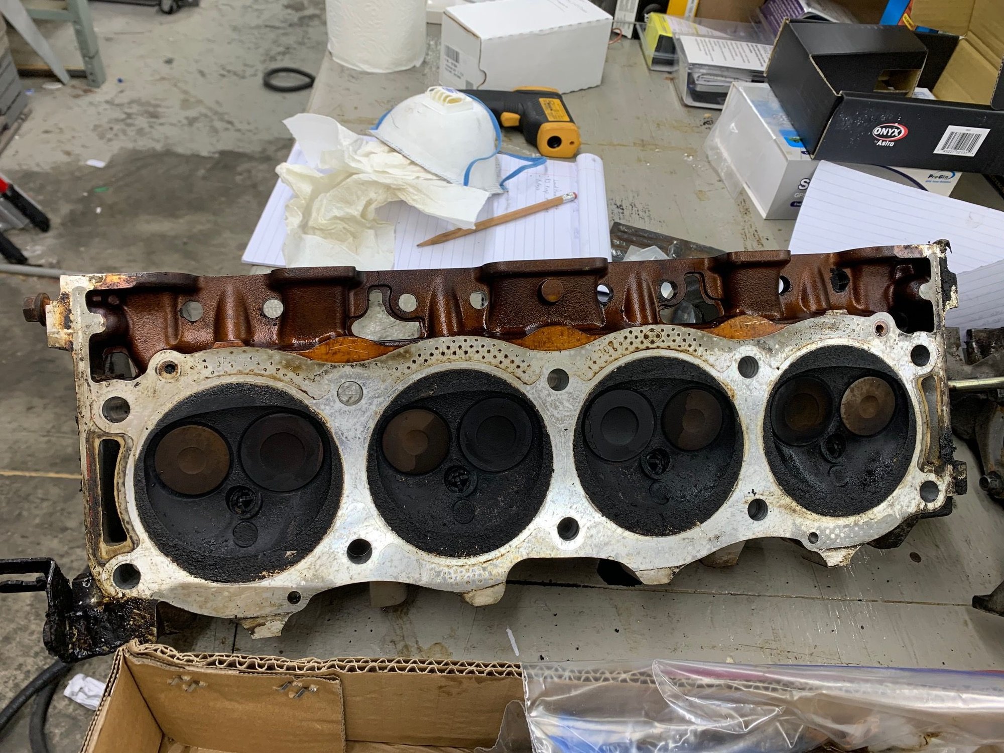

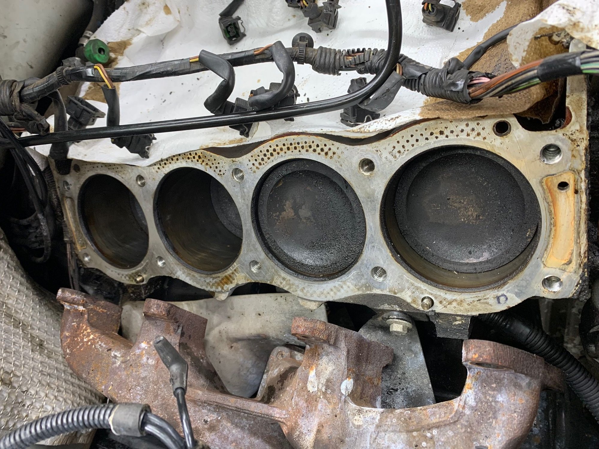

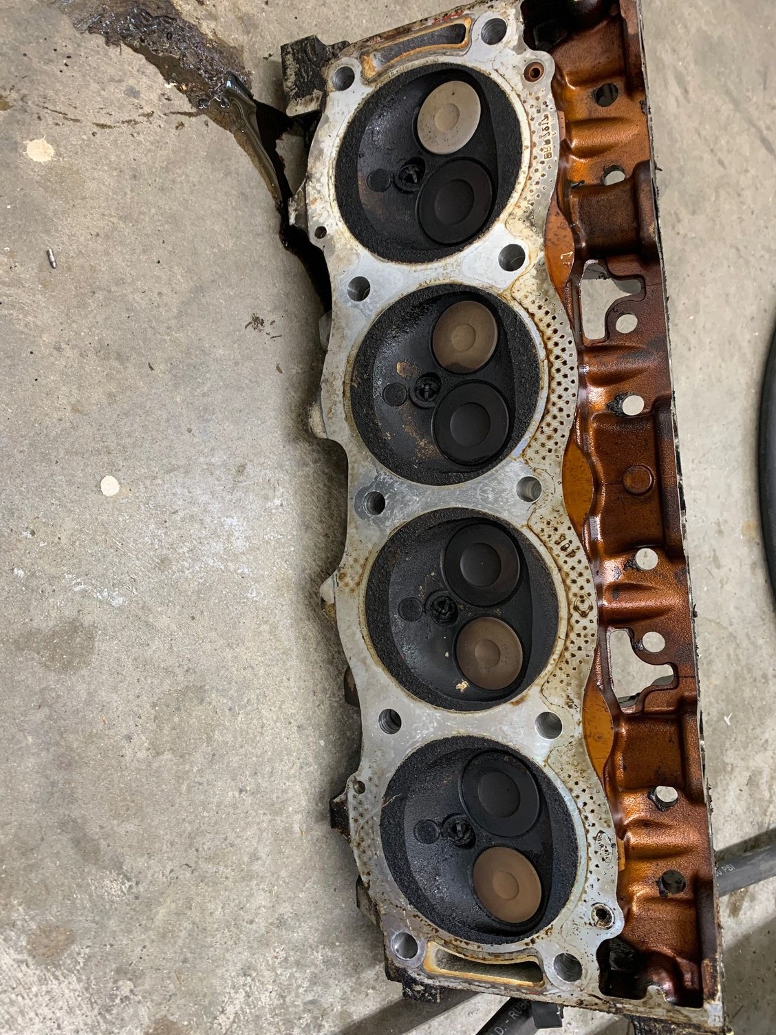

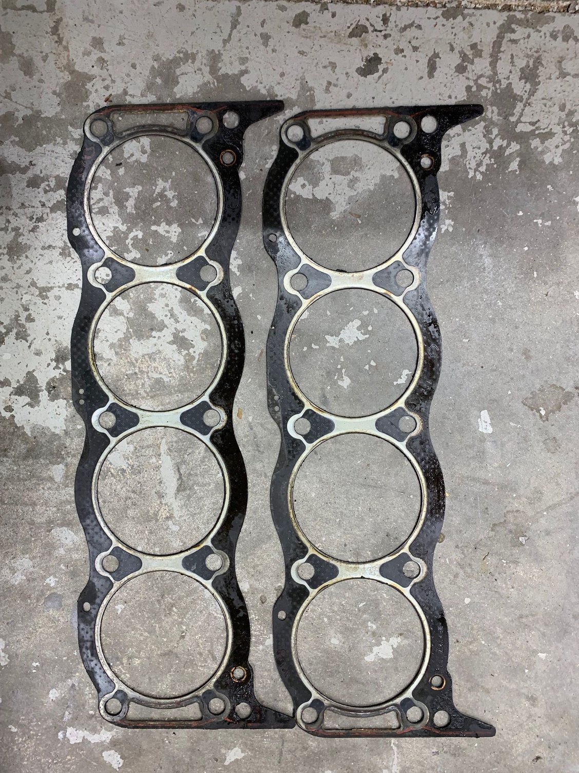

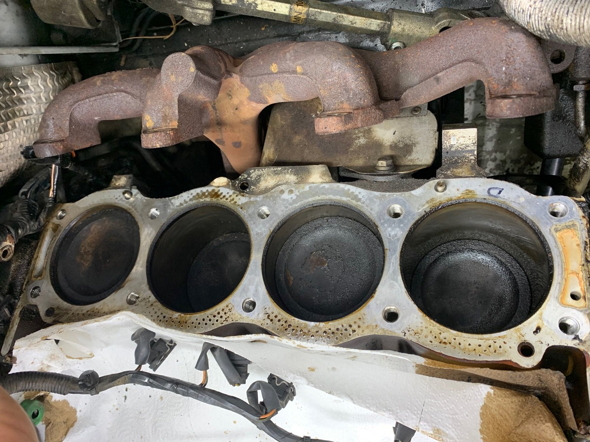

Just got the heads off and I can't see any evidence of the head gasket leaking. In my experience, I have usually been able to see where the gasket had leaked. But these gaskets both look okay. And the heads/cylinders look fine too... none looked to have been "steam-cleaned".
Have any of you seen these Bosch V8's blow a head gasket, but leave no evidence? I hate to put this thing back together and still have the problem. I'm gonna take the heads to a head shop and have them checked (and cleaned, valves seated, etc) before putting the engine back together. Any advice would be much appreciated. Thanks in advance!

Extinct, thanks for the advice. I'll probably have the machine shop check the heads, but in my experience heads that leak has always left a mark on the gasket and/or the heads (or block). The cylinder sleeves look okay visually... they don't appear to have dropped at all. I looked at the video of the pressure test kit, but they didn't show a view of where the water was coming out of the block. I searched on people who used the kit and sounded like the jury was still out on its effectiveness. Also, it seems that it would be better to check the block when it was warm... which would be difficult with the heads off and it in the frame.
I will probably recommend to Rover's owner that we find another engine. But my curiosity really wants to find out how the coolant is getting combustion gas in it.
Like I said earlier... I really hate to have the heads decked, add new gaskets, and then put it back together only to have the same problem.

Thanks for the advice, everybody. I talked to a friend who has run a large Honda repair shop for thirty years. He says he's seen 2 or 3 over years that had combustion gas leaking into the coolant, but no sign of it in the head gaskets, no steam-cleaning, and no cracks. Considering he's done hundreds (maybe thousands) of head gaskets during his career, seems like it's unlikely that the combustion gas is coming from the head gaskets. I'm currently waiting on a good straight edge so I can check the engine block's head surfaces for deviations. I feel like if a liner had a crack, I'd see at least some steam-cleaning in cylinders; but maybe not. The guy that owns the Disco will probably decide what to do once I check the heads and block. I'll update this post then.
