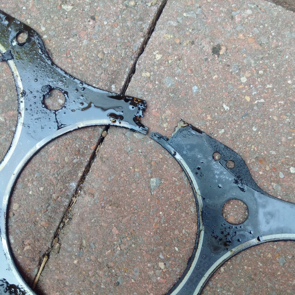

Originally Posted by Daedrix
So what do i do next?
When you take it apart you will find something like this:
I would stop driving it, buy a Victor Reinz head gasket kit for about 200, block off a weekend, and go get some harbor freight tools (maybe 100 dollars worth of tools, if you have none. And that would be all you would ever need). Or take it to a shop and pay 1500 to 2000 for them to do it. You can change the head gaskets with the engine on the truck.
