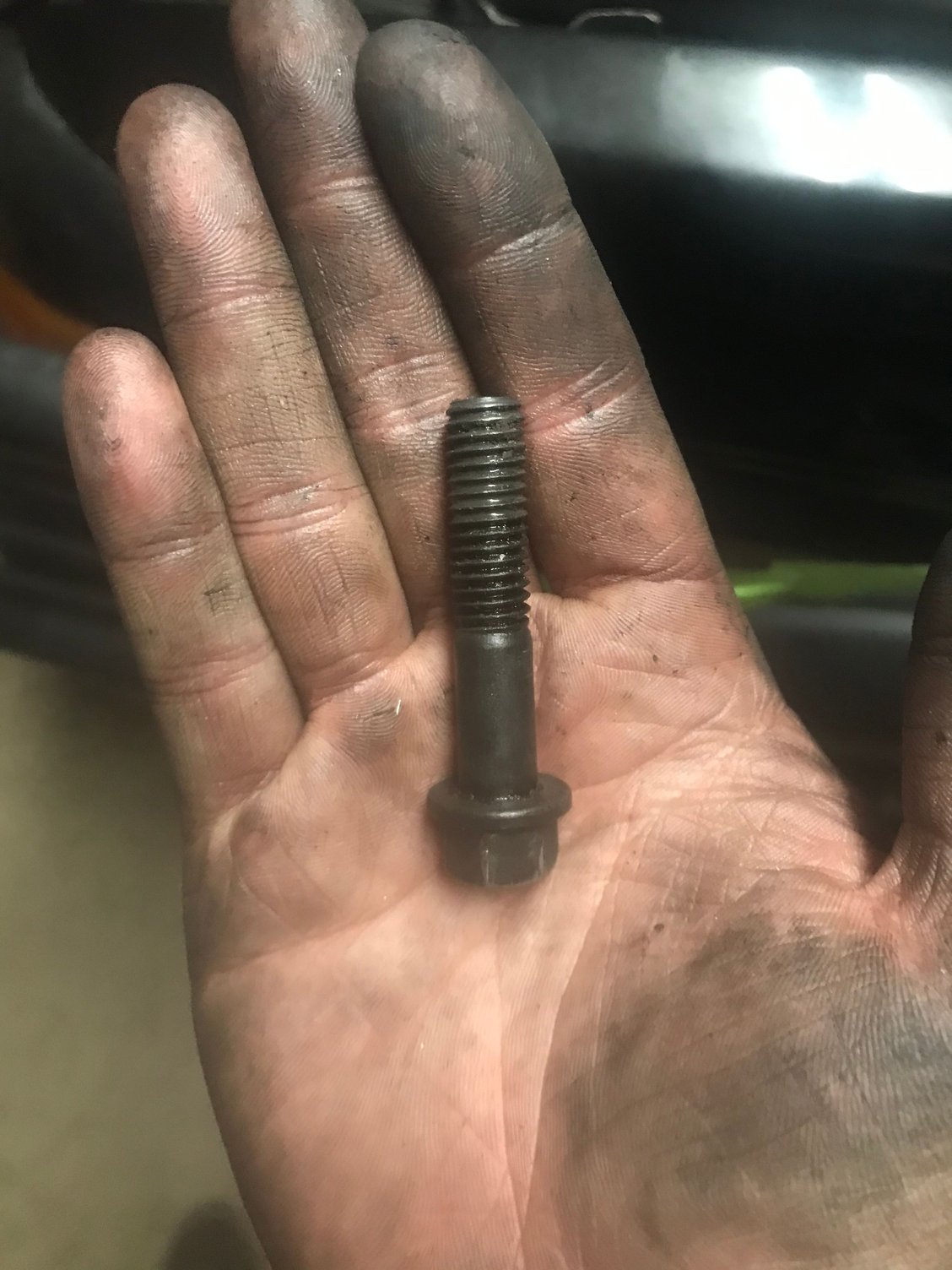

Hey everyone! So I finally got the engine to line up with the transmission for the re-install. I have a couple questions.
1) I only have 12 of the 14 bolts (4 short, 6 medium, 2 long). How vital is it that I get replacement bolts for those 2 missing medium bolts?

)1) Yes, replace the missing bolts.

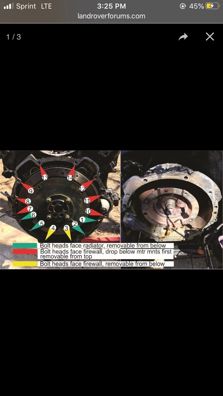

yeah I’ll find the replacements. Any idea who sells them? I’ll be checking that the torque converter spins freely when I attempt to put those bolts in. Unfortunately, I already put the motor mounts in and I already placed the top 4 bolts in without attaching any harness to them.
To give an idea of which bolts are already in, it’s 7, 9, 13, 14, 12, 10. I left 8, 11 empty since I don’t have them.

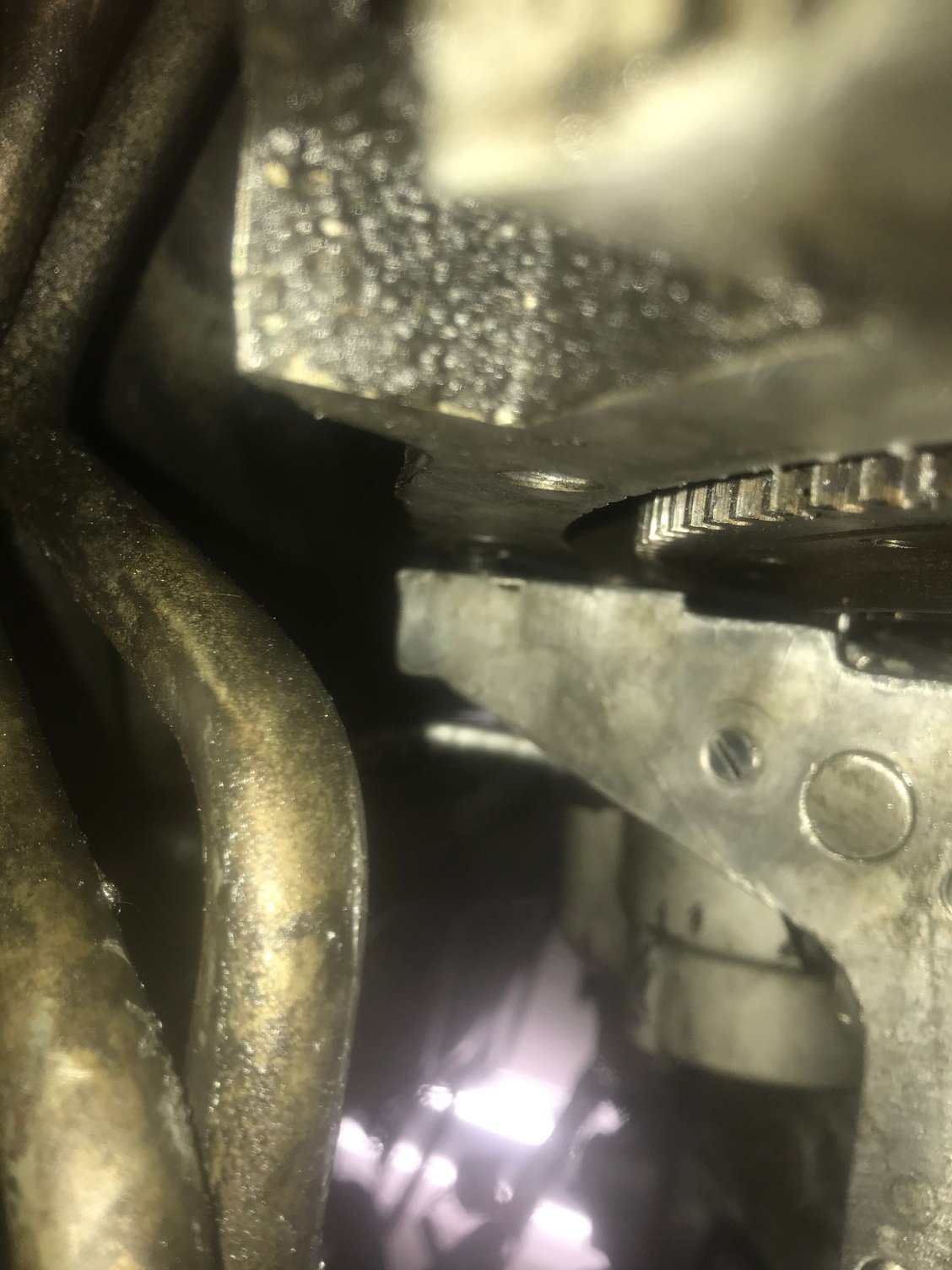

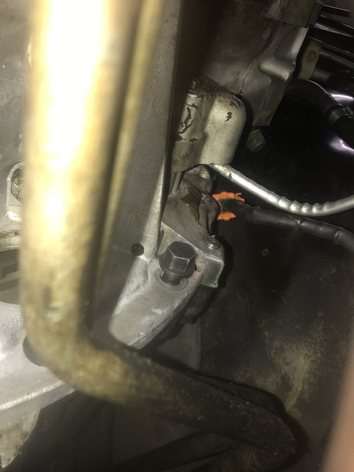

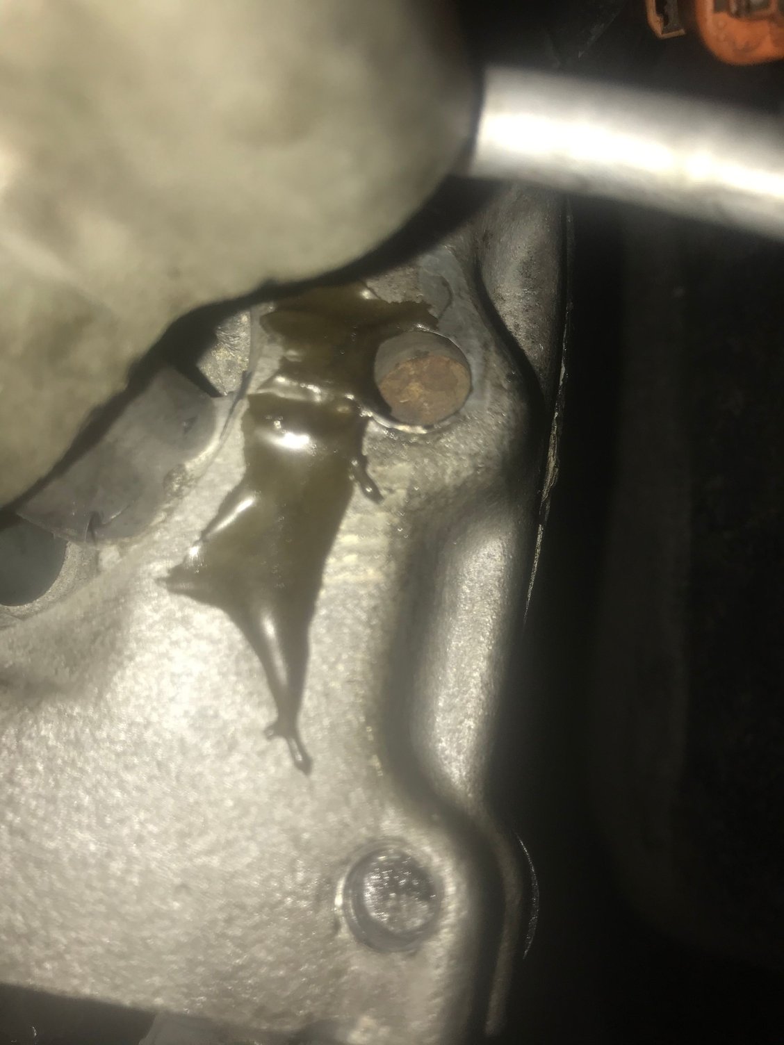

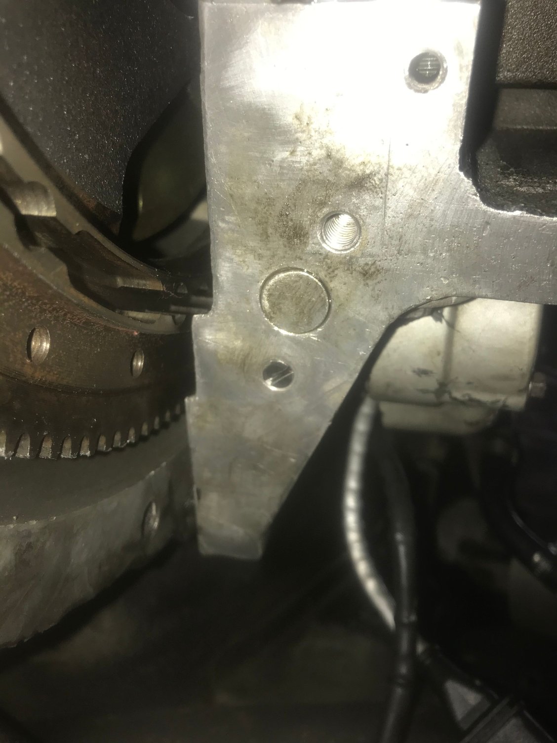

Hey everyone, so I paused on the bellhousing bolts because 2 of them are extremely difficult to get in on the drivers side. The passenger side went flush pretty easily and the ones I’m working on require a lot of force. Is this normal?
in the meantime I got the torque converter bolts in and placed the oil pan back. The crank still rotates.
This bolt is extremely hard to get in. Requires a lot of force. Granted I’m working in 1/8 turns at an odd angle

Are the other bolts tight?
If they are, loosen them til they are all just snug.
That can help the bolt thread easier.
A little penatrating oil helps too.

yes, all the upper ones are snug. Yeah I should back it out and use some fluid of some sort. Maybe graphite. But the bolt right below it wasn’t too difficult to get in. I’m not sure if it’s the threads of the bolt or if the tranny isn’t lined up precisely.

OK so I would take them out and re-tape the hole to make sure the threads are not damaged,
