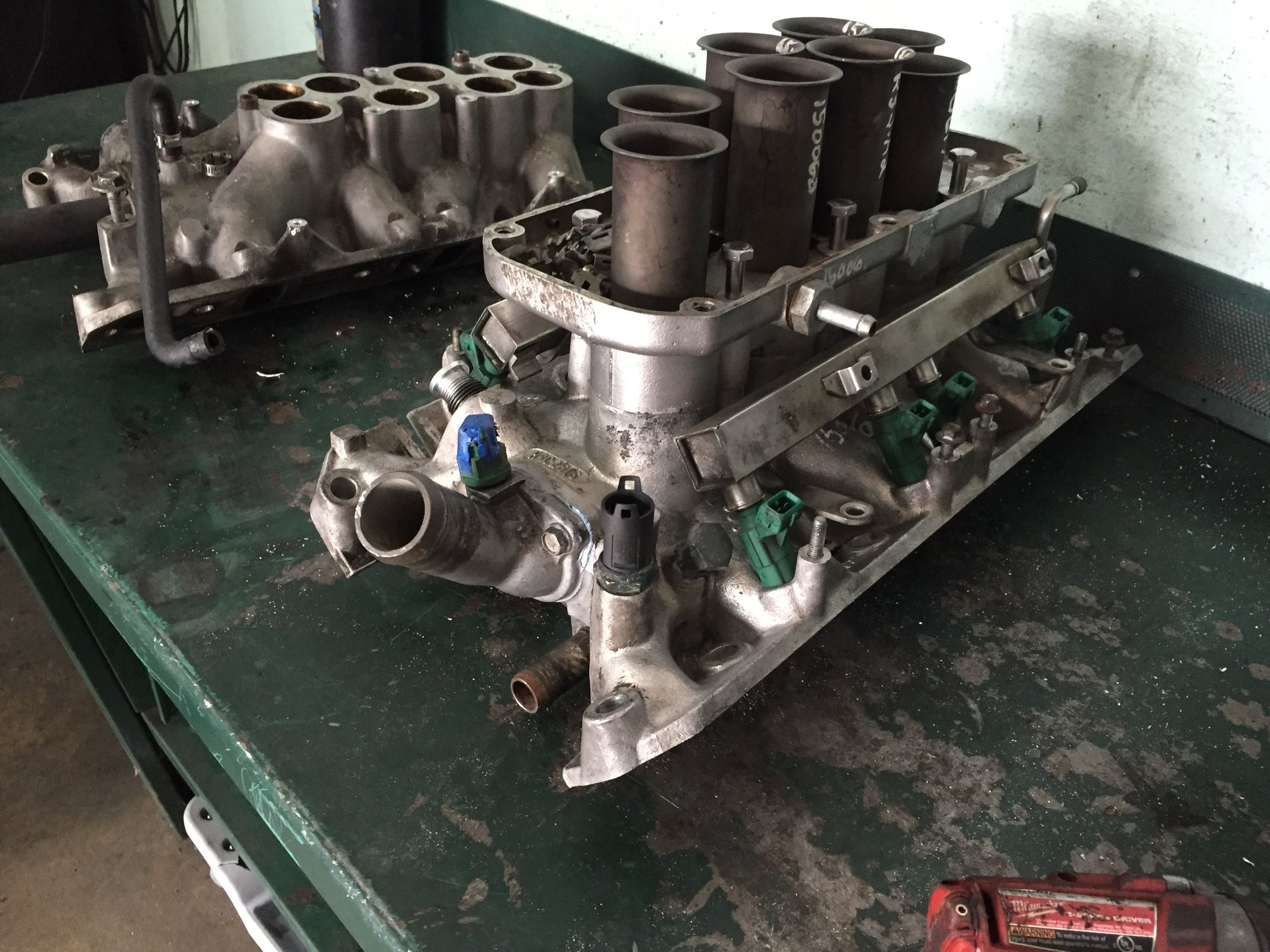

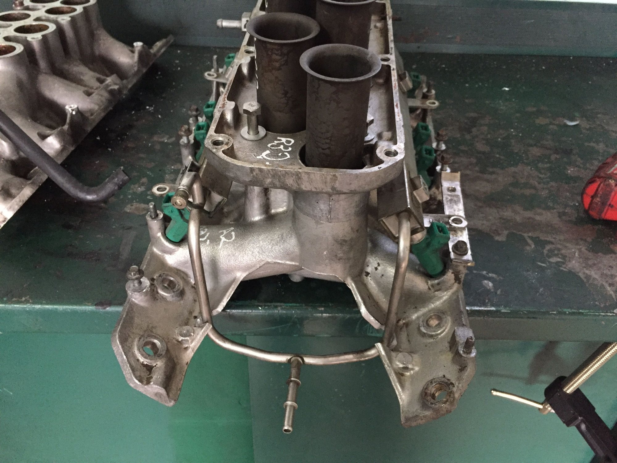

Looks as nothing will fit, all except the injector bosses. I’m going to attempt to “hybrid” this Bosch to gems intake manifold. Injector rail doesn’t fit since the back of the lower most manifold has a giant cast webb on the rear. I notched it some, just to clear the rail tubing.

ive been working on swapping the bosch on a 14cux, close enough to gems to know what doesnt work..
tps
idle air controller
fuel rail doesnt fit
intake hose doesnt line up with airbox
thermostat is completely different
throttle cable is very different
cruise control bulb mounts differently

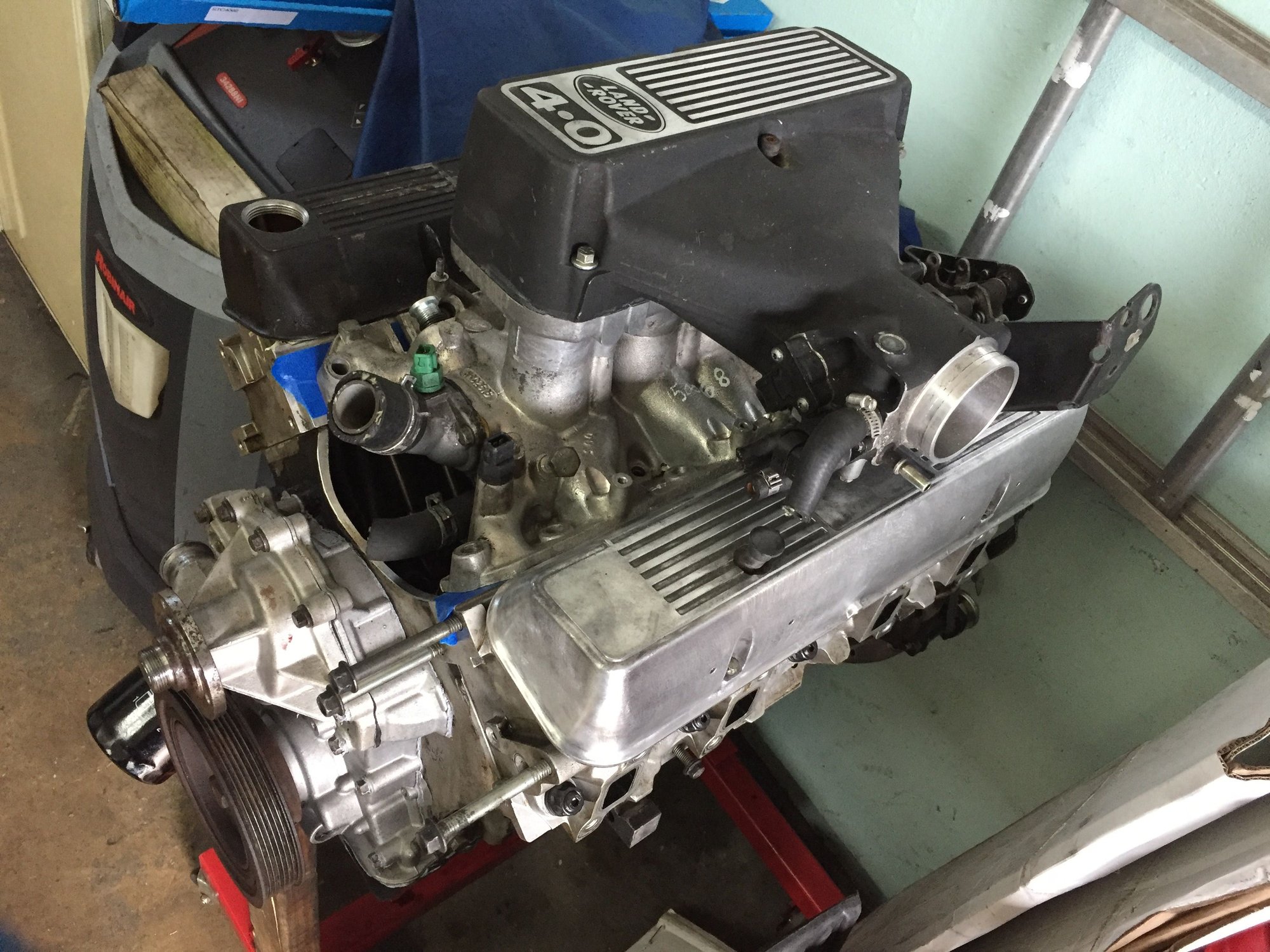

Nothing physically “bolts in” except for the lower manifold section to the heads. No real purpose other than looks and an attemp to hybrid the 2 intake manifolds. The rebuilt Bosch 4.0 I just finished and on a stand, except for the intake section. More progress should come later today. Picture is a little peek at the close-to-end result. Still have to strip the other side rocker cover as someone attempted to paint it.
