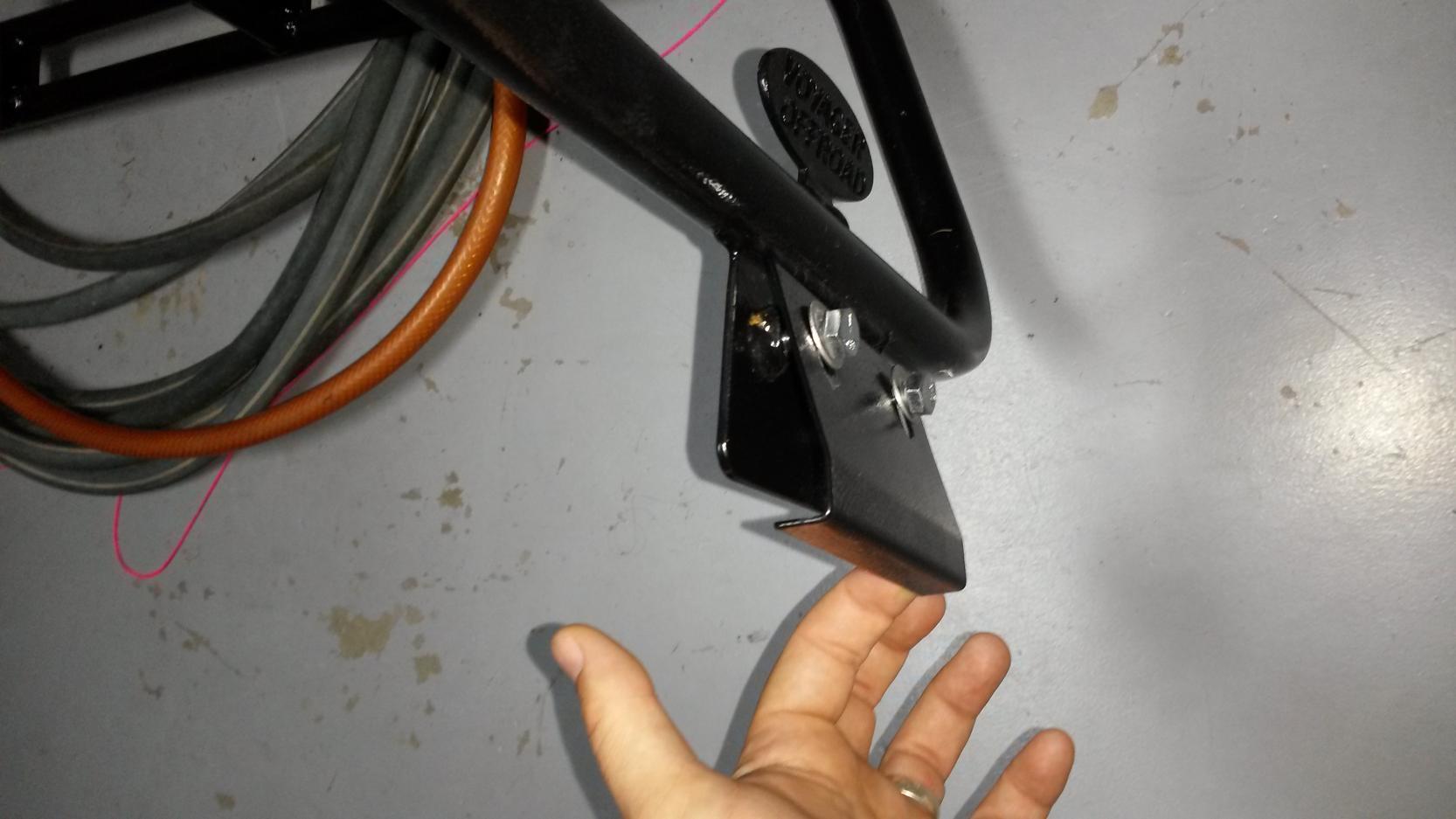

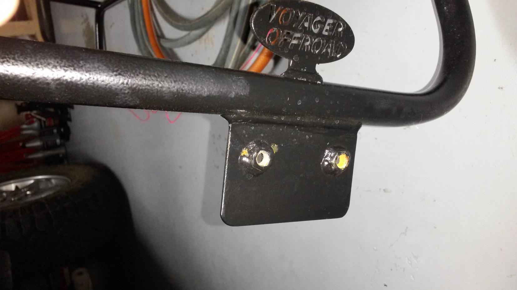

I have the rack off the truck right now so it might be hard to tell how it mounts but here are some close ups.

Good to see you are making progress! As for "thicker stock" on the brackets, that's a big YES if you plan on putting any real weight on the rack.
And for as little as it will cost, you might also want to add another set of brackets at the A Pillar.
Good luck!
yes, doing 4 per side and i am making the bend longer as well. tomorrow will be fun!
Thanks again for the suggestion.
