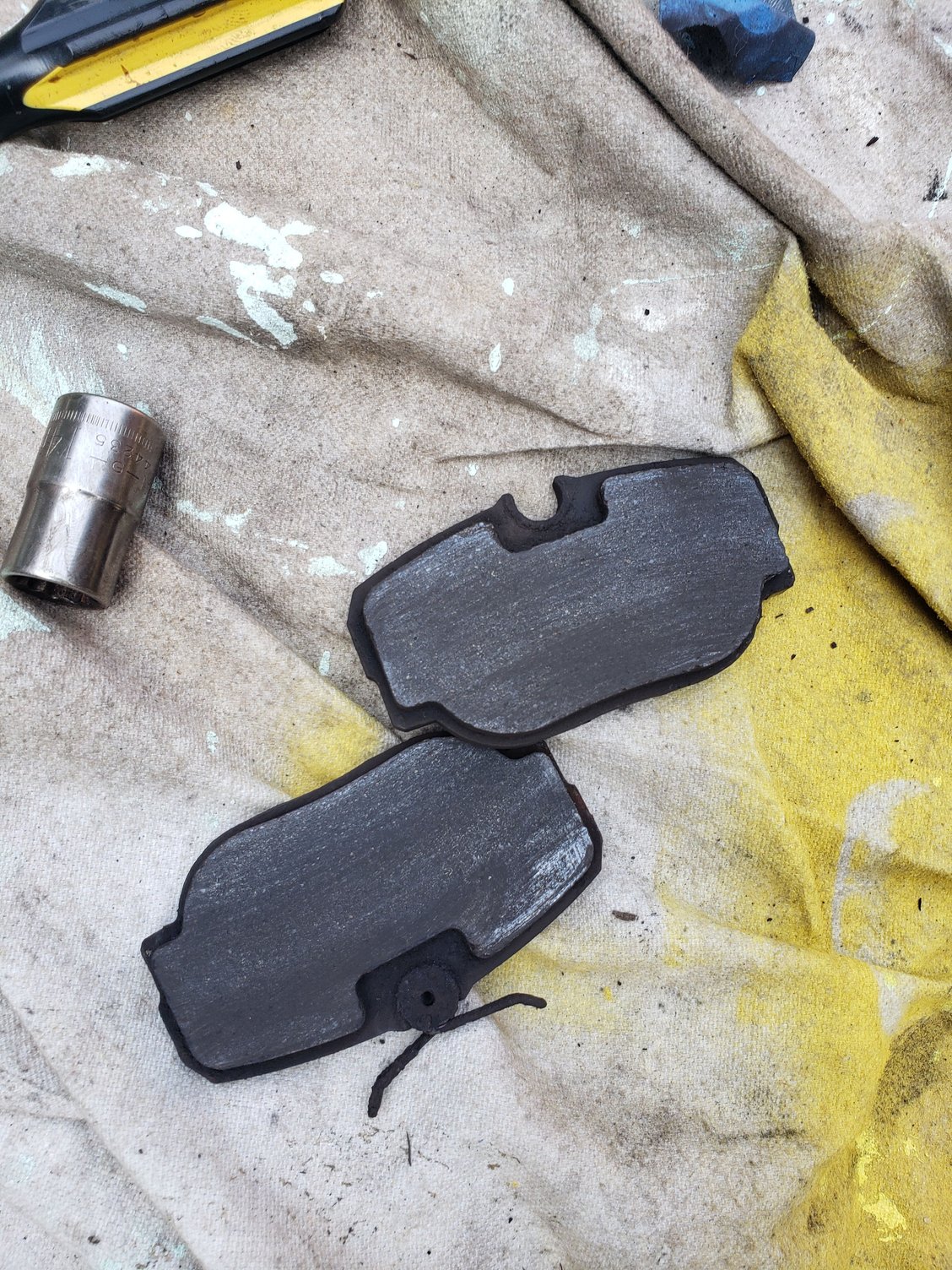

I bought replacement caliper pins and installed them. there may have been some play on the passenger side, the pin had some wear.
when I got to the other side I saw the pad was missing a spring. Swapped the in board an outboard pad so the spring did not matter.
truck no longer rattles. Not sure if the fix was the pins or the pad. Either way a result.
