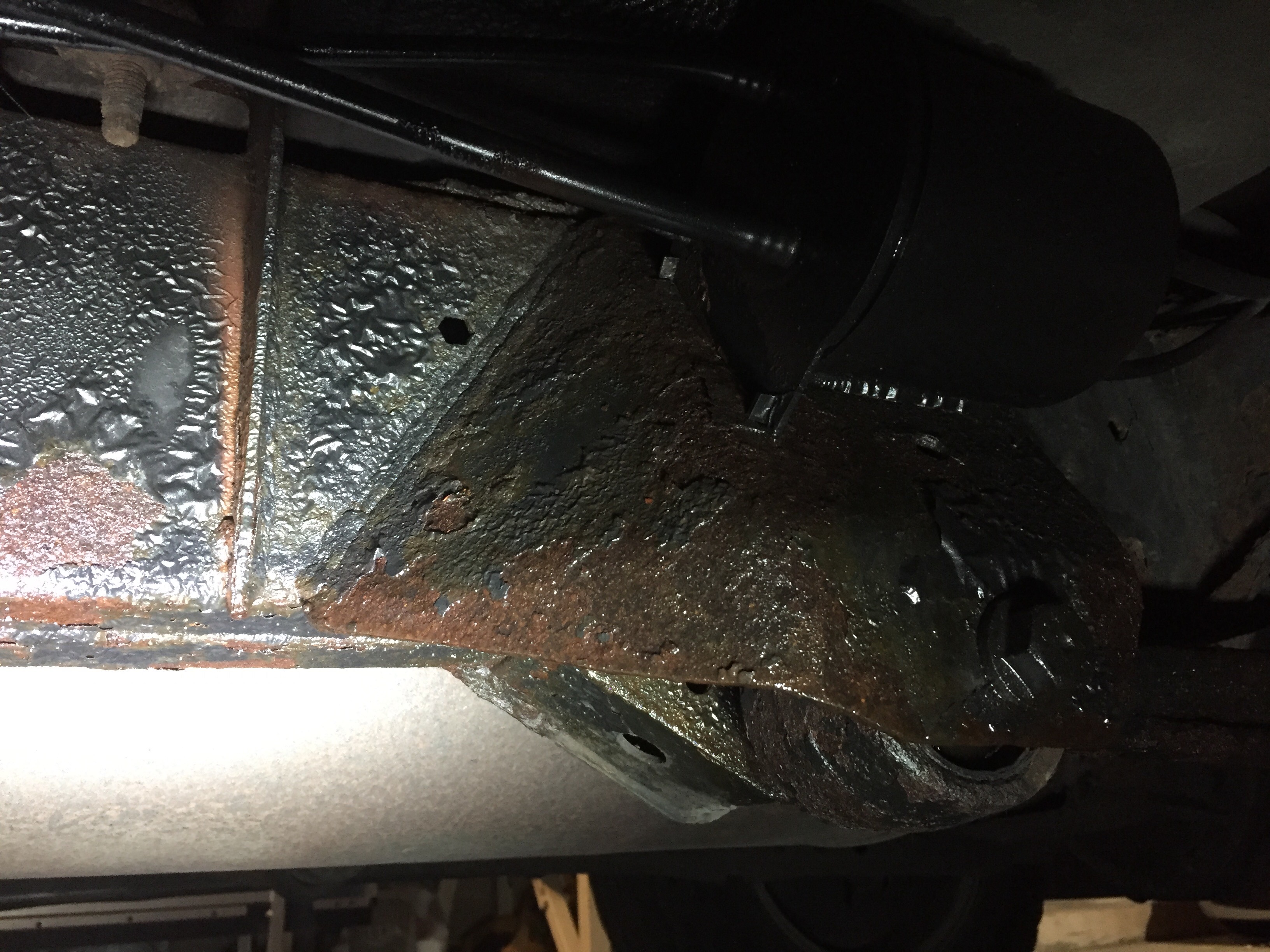

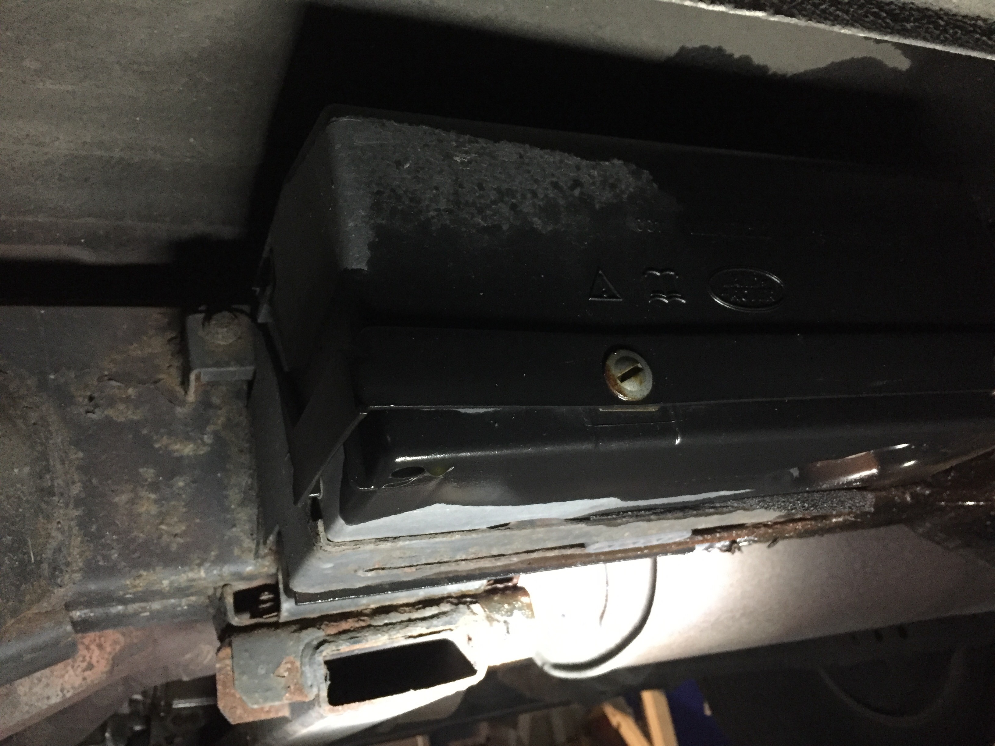

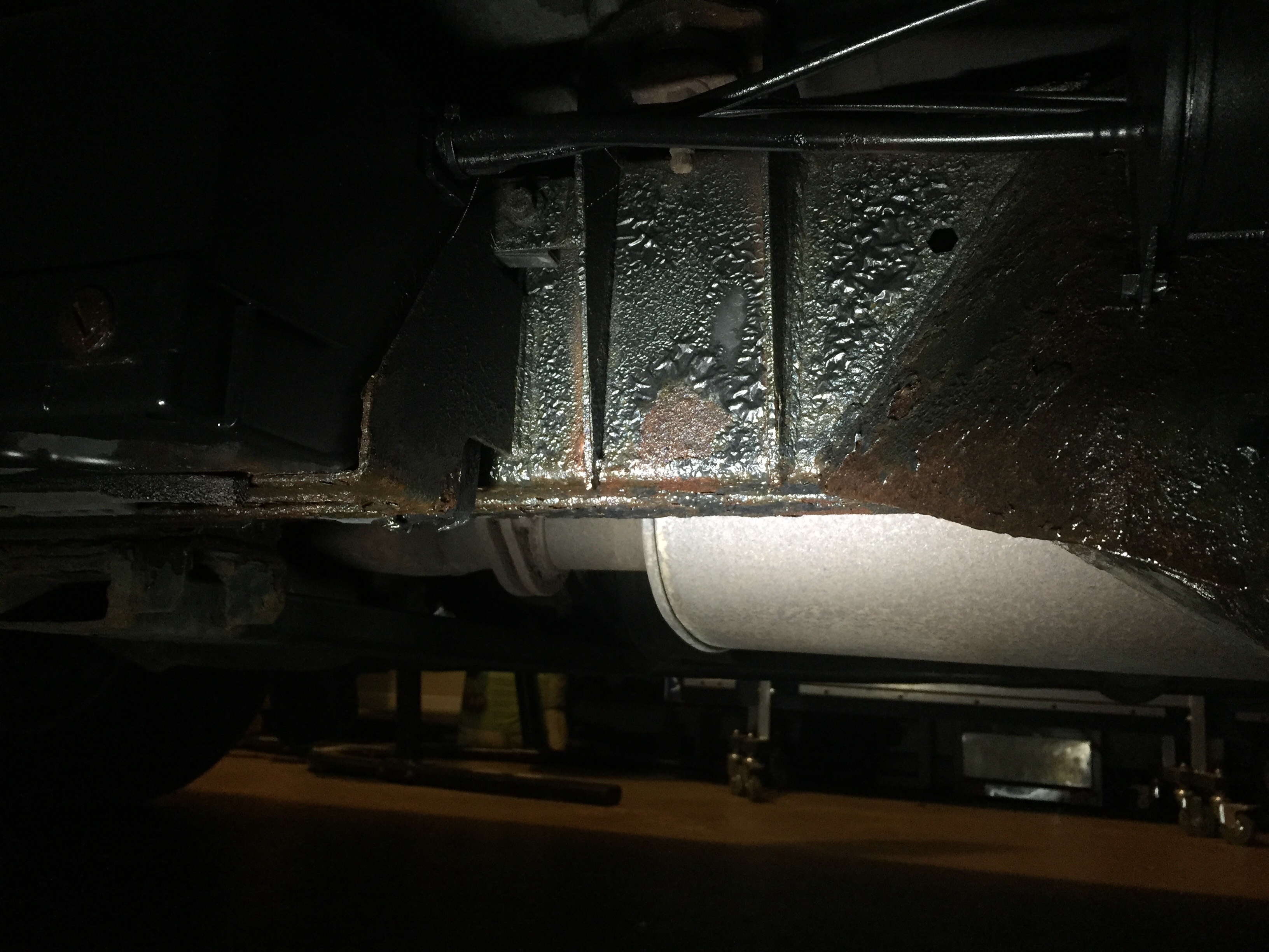

Hope someone can shed some light here.
My wife took the truck for the first time in many months on her way back she lost brake! never seen anything like that. Felt bad for her driving like that.
Since it's night, i took a quick look around and under.
seems like a lot of brake fluid coming in and a round the Rear Air Shock pump.
I am not sure how they are connected. without opening i don't know what's going on behind. is it possible that there may be a brake line behind snapped?
has anyone have this experience? here are some pic.
will appreciate your help.
Thanks

Hard to see where is the leak from, but Sure looks like brake fluid has ate the paint off of chases,,,,
In good light have her pump the brakes, while you look for the source of leak, after you find the leak wash the brake fluid off very good with lots of water b4 further damage to underbody paint, or it will cause lots of unwanted rust later on, even in Texas,

That is my plan tomorrow. I am assuming there is no connection with the air shock pump, right? It runs on Air not connected to brake system.
I have to open the box to see where the leak is.
This sucks!!!
I am pretty sure the line going to rear are ruptured due to rust. need to replace both of them.

The SLS air suspension and the brakes have no connection at all.

I found the Leak it's right behind the Air shock box. I need to replace both lines.
