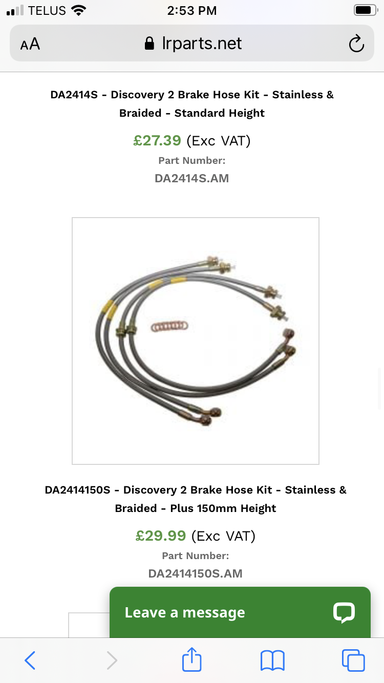

I found these extended brake lines plus 150 mm which is 5-6 inches longer than stock. I was thinking of putting these on when I put on my 2 inch lift.
for $29 euros I couldn’t resist
but is a extra 6 inches to much ?

you can pull them out of the harm of the tire with old throttle springs. That's what I use as I'd rather have the lines be longer than necessary.

longer better than shorter......and don't forget to extend you ABS sensors...
