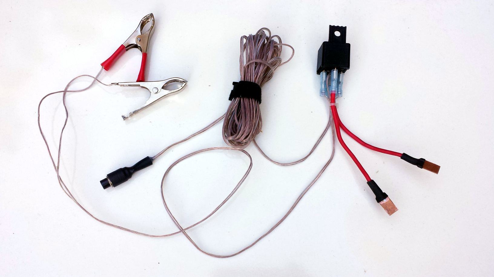

Thanks, this confirms my suspicion. I will get a new MC and I have to flush/replace the brake fluid anyway, which involves bleeding. I can make a power bleed cable (relay trick) myself and have a leftover check valve from one of my projects in order to build the one man bleeder. Still, I have my son to assist me. In meantime I am going trough all the great write-ups in this forum, but it looks pretty straight forward so far.

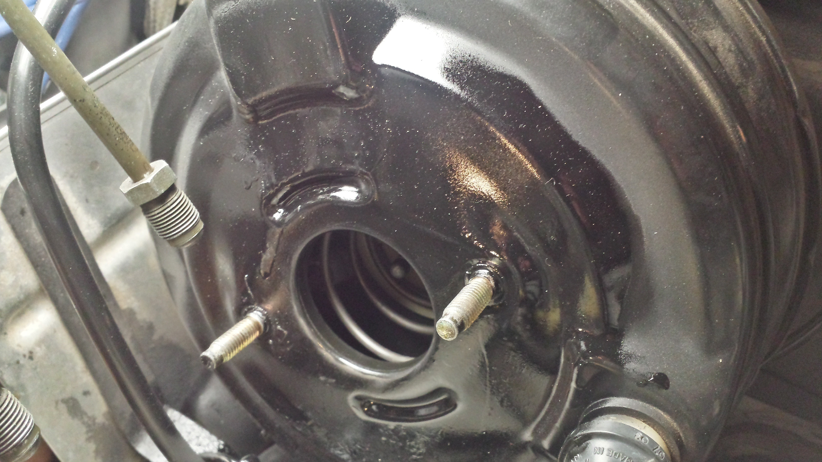

I got a new TRW branded master cylinder. Successfully replaced the master cylinder:

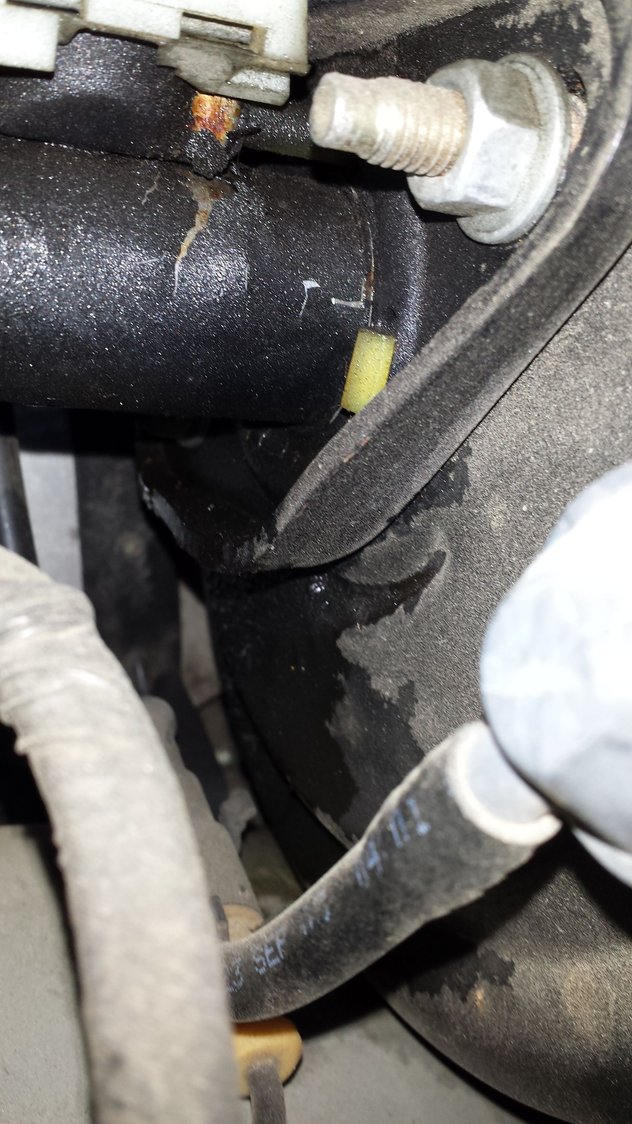

After the MC removed, corrosion on the booster is visible.

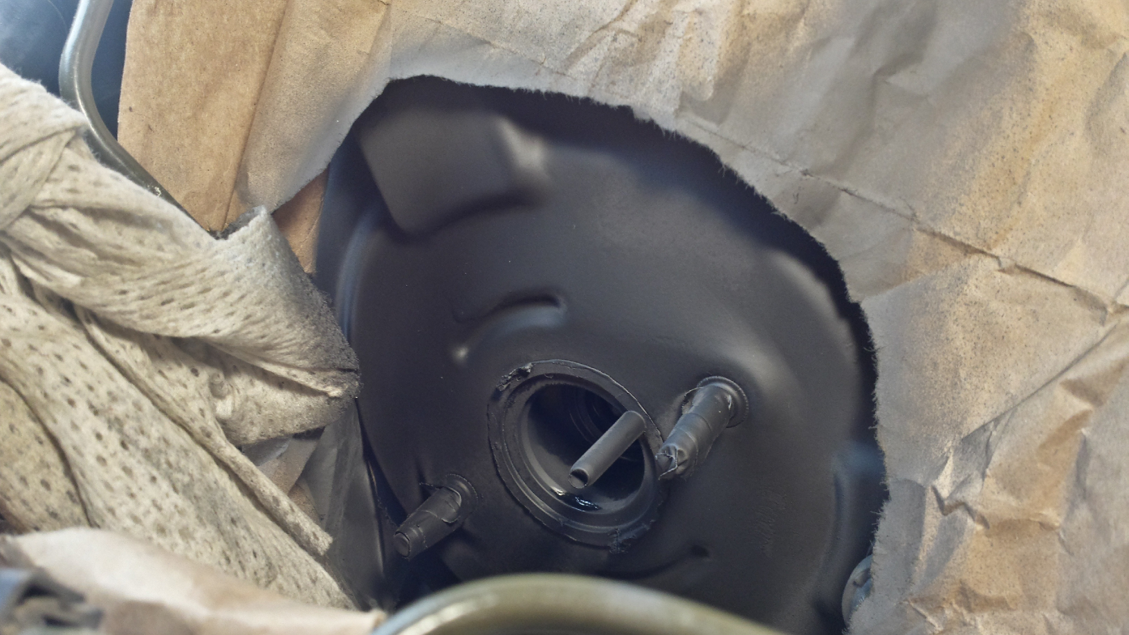

Removed the rust with a Dremel, the yellow plastic cap from the defective MC was used as cover.
Primed ...
... and painted.

After a traditional bleeding with the help of my son I did the "HDC bleeding" and then a power bleeding with the self made kit above. Take the ABS relay out, bridge the ABS relay contacts, open bleeder screw, let it flow until clean and no bubbles, close bleeder screw (ignition always off).
