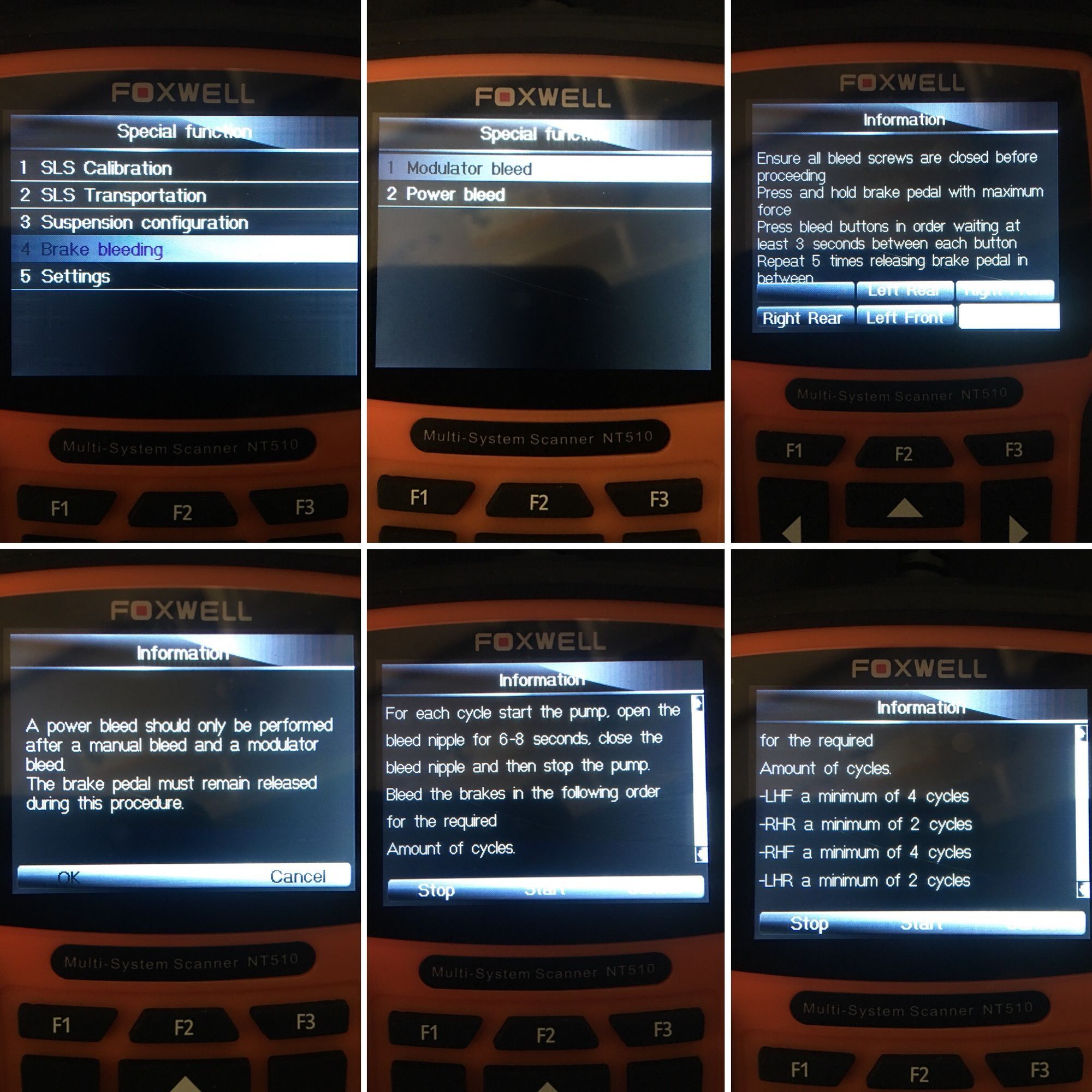

Alright.. Ordered Foxwell NT-510 that will do abs activated bleeding as well.. $150. Just need to know if I need to take MC out and bench bleed it first. thanks!

Using the Foxwell makes it so much easier to power bleed the abs module. It shows you how to do it step by step.
