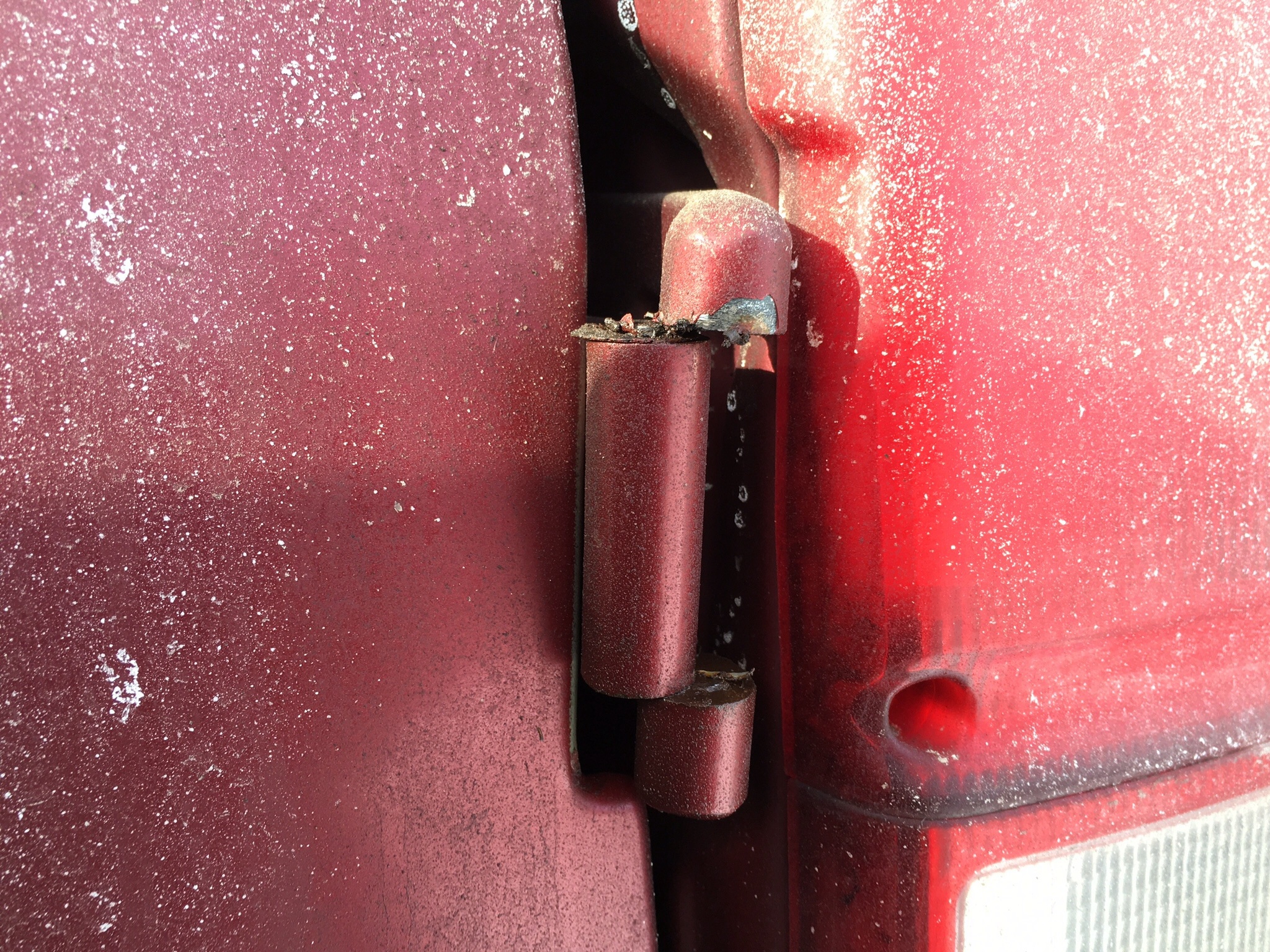

Great day in D2 land today! Went out to load my skis into the rear of my D2 and the barn door just about fell off when the upper hinge snapped. Luckily my wife has a "real" car LOL, so I took her RAV4 skiing but I need to get my D2 drivable.
Anyone replace the hinges on the barn door before? Is it as simple as unbolting the old ones, bolting the new ones in, lining up the door, and dropping in the hinge pin?
I know the door is a beast, can 2 people handle lifting it into place?
Thanks Guys! My 3 Amigo repair is gonna have to wait.....

Well, I guess I will update my own thread. I removed the upper broken hinge which was quite easy to do. This allowed me to close the barn door, so my truck is now drivable. I ordered a used set of hinges from Paul Grant, so should install those and hopefully good to go.

Just FYI, one of the hinges (I guess the bottom since you've already removed the top) has a rivet you'll have to drill out. No need to replace it really, the D1s had the same hinges with no rivet.

Thanks for the advise Alex. I have removed the upper hinge, but not the lower.
I did read about those rivets in the lower hinge, was wondering if they needed to be replaced as I dont have a rivet gun, and space is pretty limited there and I plan on doing all the work with the door in place. Would not want to remove that beast of a door!
