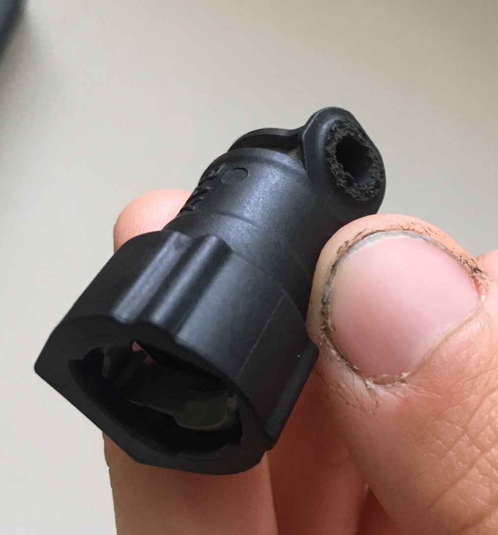

Spent about 20 hours this weekend doing a head gasket swap and coolant leak down check. After getting the heads back on and beginning the re-fitting process, realized I had broken the fuel line adapter that mates into the fuel rail supply. Its a brittle plastic piece that I must've unknowingly cracked apart as I pulled out the lower intake manifold.
Brought the head gasket job to a quick halt, obviously can't risk fixing it myself with glue and a prayer, so I have to find out a way to replace this part. Anyone ever make the same mistake as me? Trying to determine if I need to replace the entire fuel feed hose or if I can just get a new adapter plug. Seems like that metal band sealing the hose around the adapter is not a clamp, so I am doubtful I can just stick a new plug in. Pics below

Seems like the fuel line and the rail are both 5/16" dia. Ordered this new connector, hopefully fits snug.
https://shop.advanceautoparts.com/p/...135/10842560-P
Ill try for next week some time. Is there any sort of air bleed process I have to do for the fuel injection system when I get everything hooked back up and ready for liftoff?

Easiest fix would be to clamp a barb to the old line and add a couple of inches of new line, clamp new line to fuel rail.
If you relocate your coil packs you will have ample room to check on and repair this area in the future. But If you get it snug the first time it should last year's.

Two things I hate about this engine... SAI and the coil pack. Relocation is definitely happening in the future. But I gotta hold off on that for now.
You're probably right about adding an extension. I'll see what I'm working with when I get back to the garage next week.
