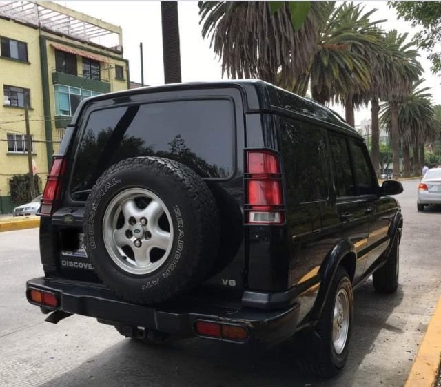

Bonus pic:

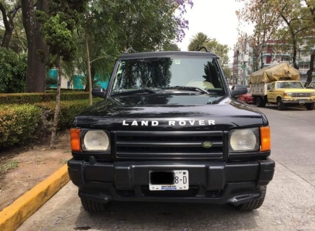

Seats look fine in the pics... the paint looks REAL fine judging just from the pictures. I'll be able to take a closer look on Sunday. Here it is:

That paint looks great. I have/had 17 so far. Here is my priority order:
1. Frame rust - behind rear wheels. If it is worse than surface rust you need to walk away unless you are or know a good welder.
2. Paint - Paint is expensive, everything else is cheap relative to paint.
3. Mileage - Mileage sets the resale value on these. At 110k you are at the low end of what these vehicles currently have. Your deal so far sounds excellent.
