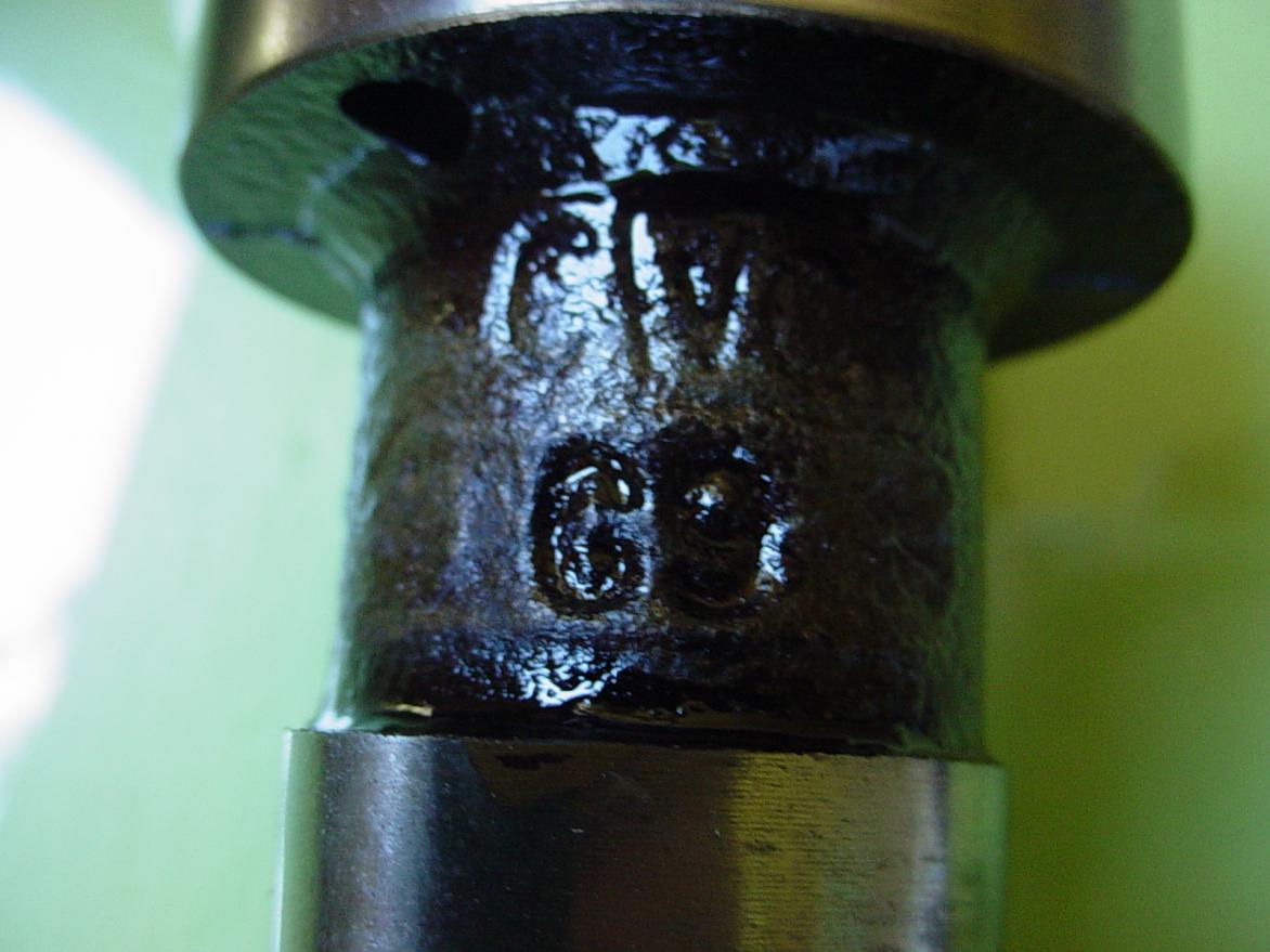

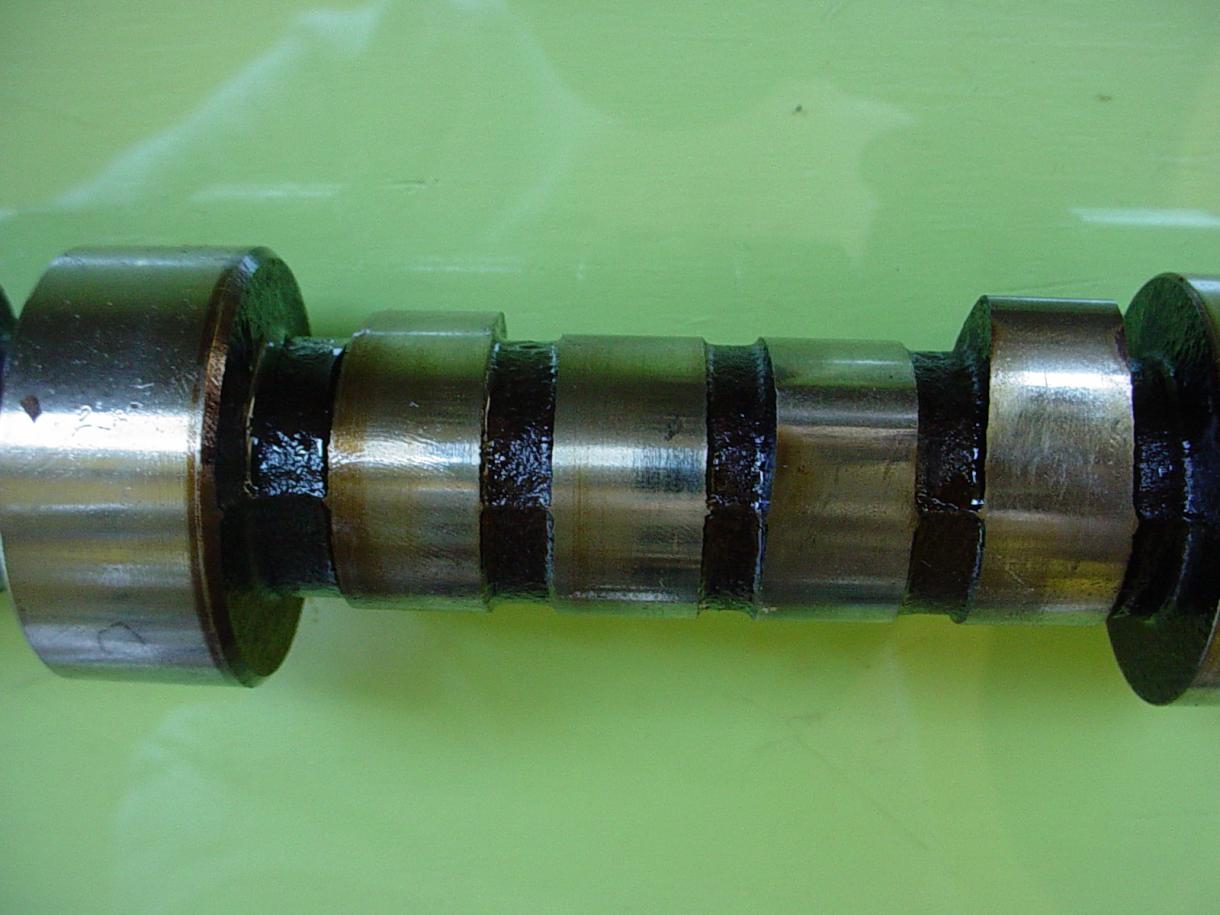

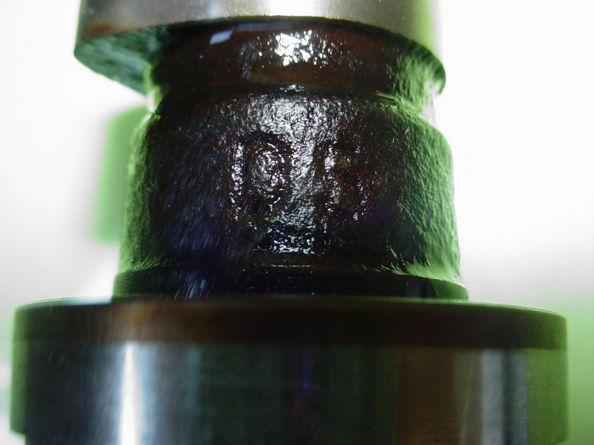

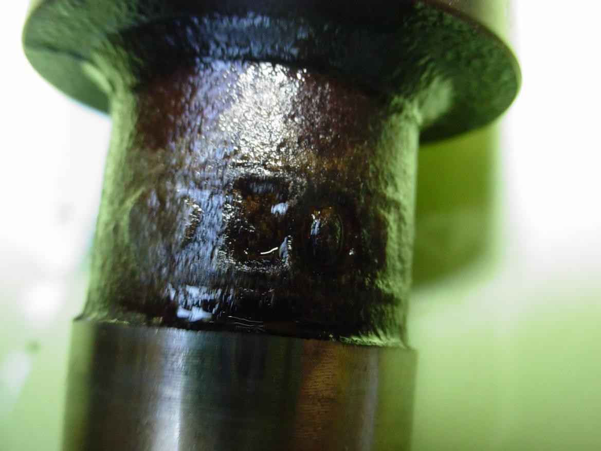

Is this a genuine LR cam and is it worn out? or are the dark lines on the lobes just varnish? looks like may be worn through the plating? from an 00 4.0
I'm putting in a new cam and lifters and wondering if this one is worth keeping or seen it's better days?

Looks fine to me.
You could replace it.
But then what do you really put in there?
Could get something saying ROVER but is made in China with gosh only
knows what specs.
I left the old cam in my D1 and replaced the lifters.
I guess that is a no-no...
D1 had 170,000 miles on it and still going.

ok I don't how they look when they are worn. I was planning a complete rebuild on this motor using 4.6 crank and rods and thought I would get new cam bearings, cam and lifters. was thinking maybe a crower cam. I haven't started researching that yet.
I'll post pics of the lifters tomorrow and maybe you can have a look at those. The lifters don't look that worn to me but I'm not a trained mechanic so really don't know what to look for.
If I get new cam bearing and new cam will get new lifters as well but would like to hang onto all of this if it's still good.

The one on the right (obviously) was my old one. There were enough uneven wear patterns on the lobes for me to replace it. To be honest it is very hard to tell just by looking at them if theyre worn, but mine did look worse than yours does.
As an aside, my new cam is a crower 229 (left). Now that it has worn in and the computer readjusted the fueling, I can definitely feel a power difference.

In all honesty, judging by the photos, there appears nothing wrong with the cam. It does not have any scoring or deep marks but the only way to check accurately is by a micrometer against the spec and given exhaust and inlet lifts and also check the diameter of the bearing journals. It is obviously not a high performance long dwell cam and from the photos doesn't show signs of wear on the cam ramps. IMO providing it checks out on measurements within the set tolerances you would be throwing $$$ money away.
Do you have a surface plate, vee blocks and a magnetic stand and dial gauge as the cam could be set up with a dial gauge and rotated in the vee blocks and comparisons made between cams as well as an initial micrometer measurement check.

looks like number 7 cam lob is wiped out to me
if you look at the last two pictures you can see something has been running off the cam lob to the right.
the spot it is running on is the casting seam, I would assume that lob is below specs.
