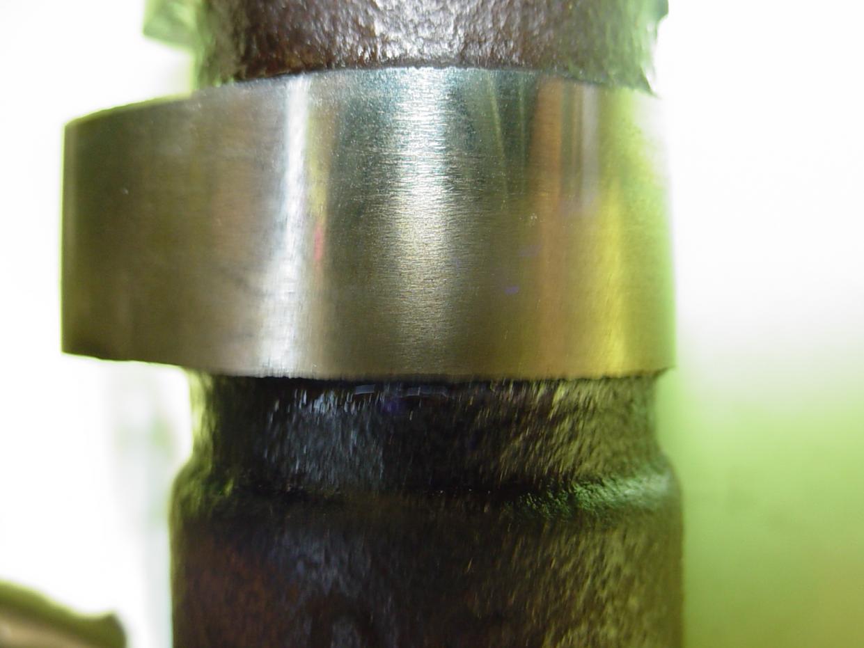

Is this cam worn out?

It's hard to tell from the pics. They almost look pitted, but it could be the oil film? Clean it off with brake cleaner, and see what it looks like.
The 4.6 cam is, If I recall, a more aggressive profile than the 4.0 cam - so if I were changing cams on a budget, I'd buy one of those instead of the 4.0 -or you can go straight to the 229 or 230...

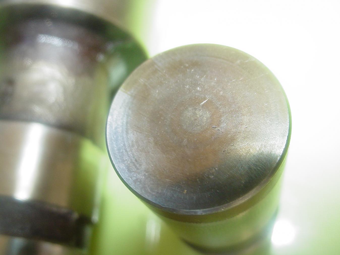

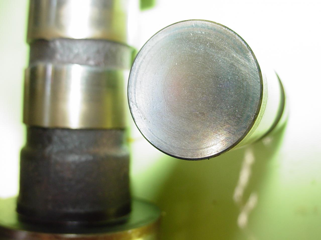

Originally Posted by drowssap
looks like number 7 cam lob is wiped out to me
if you look at the last two pictures you can see something has been running off the cam lob to the right.
the spot it is running on is the casting seam, I would assume that lob is below specs.
Thanks drowssap, here's #7 lobe and lifter.(edit #8 lobe and lifter) I think that's paint you see on the casting. had a thrust plate didn't feel like it could have moved enough to run off lobe but what do I know.Looking at it before I pulled it everything looked lined up but I know these things can move. I know it was hard to pull the cam out, tight fit maybe suction and was hard to get it started out.
I'll have to mic everything. may just go for a crower cam and lifters and new bearings.
My camera is 10 years old with only 2MP so, pictures are not so good. overdue for a new camera. I think my phone has more MP than this old thing.
So do the genuine rover front bearings have the swirled oil grooves?
I suppose if I'm going to do this I should just do everything, but not flanged liners just pinned liners.
Attached Thumbnails Is this cam worn out?-dsc00007.jpg   Is this cam worn out?-dsc00010.jpg

I doesn't look bad in that pic the first set of pics, it looked like one was ride on casting flash next to the lobe of the cam.
I am not sure what the stock cam bearing look like but i assume they are smooth like everyone else.
Thanks Dave, I think that's oil film, wiped it off and don't see any pitting but if I go with 4.6 setup, I'll just get a crower and lifters and new bearings.

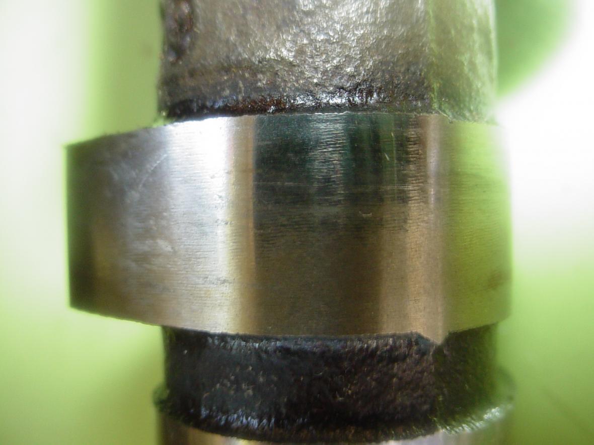

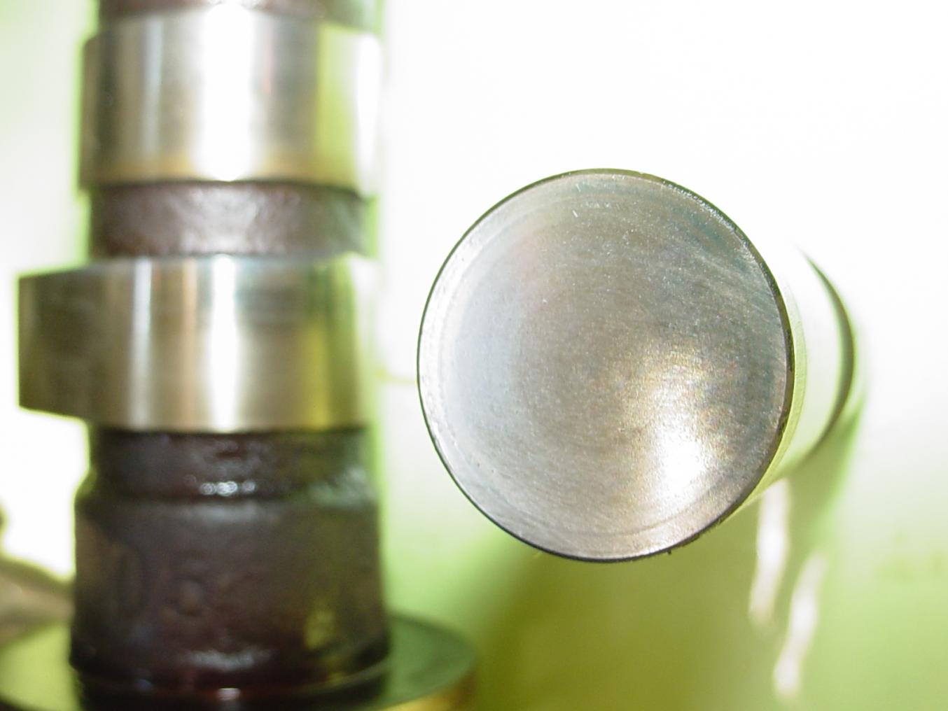

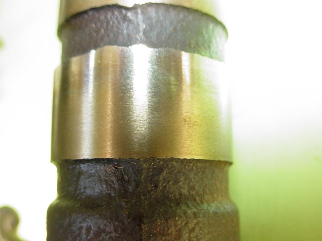

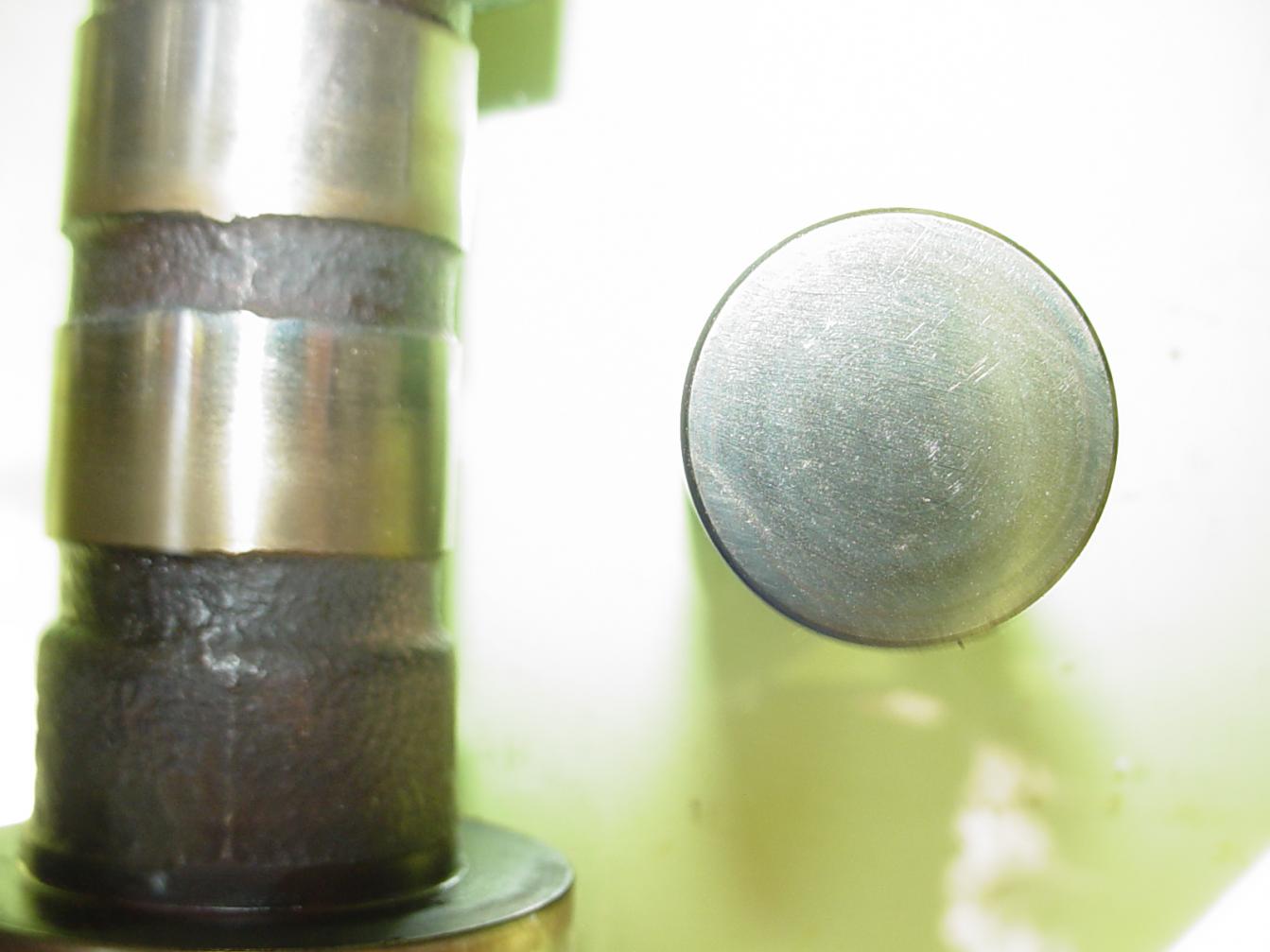

Actually I had the numbers mixed up. The picture I put up before was the last lobe on the back end and goes to #8.
The first lobe on the front end goes to #1 and here are pictures of #1.
I don't think it was riding on the casting because the casting line on the flash is not touched.
I know my pics are hard to see.
Thanks to everybody for all the help.
hmmm, I see where you are taking about to now. between two lobes in next to last pic from the first post.
thanks for pointing that out. That may be a finished place from when they were grinding the cam, non of the lifters look buggered but, after tearing this completely down today, I see I am going to have to change all bearings, cam, main and rod bearings. so might as well buy a new cam and lifters too.
