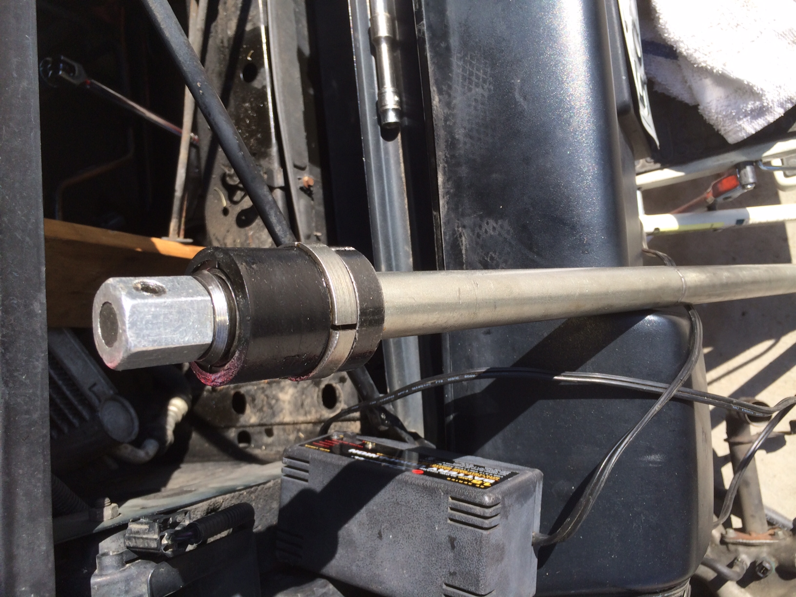

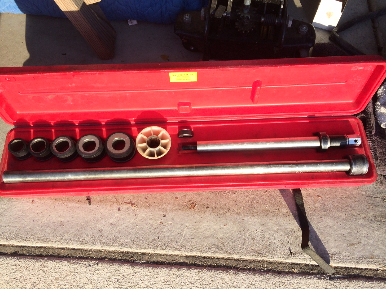

Alrighty folks, here's the latest. Big thanks to Craig over at JC's British 4X4, here in Denver, for giving me the CliffsNotes version of replacing the bearings. Forgive me if this is a bit rudimentary, but I haven't found this anywhere, so I figured I'd share my experience.
Having the appropriate tool is of the utmost importance. I couldn't find a free loaner at any of the usual spots, so I did some Googling and found a local tool rental shop that had one. And they had a great name: "Butts."
After selecting the appropriate sized expansion plug, the old bearings get driven out starting at the front. They get driven straight back into the crank case and will more or less fall to the floor.
Attached Thumbnails Camshaft removal- check my math please!-photo-17-.jpg   Camshaft removal- check my math please!-photo-16-.jpg   Camshaft removal- check my math please!-photo-12-.jpg
