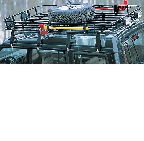

Originally Posted by hk9176251
can 35" tires fit on a 2004 discovery?
I don't think this particular tire is a 35", but I would say you could easily fit one or two on the Discovery. I just wouldn't put a 35" tire under the Discovery.
