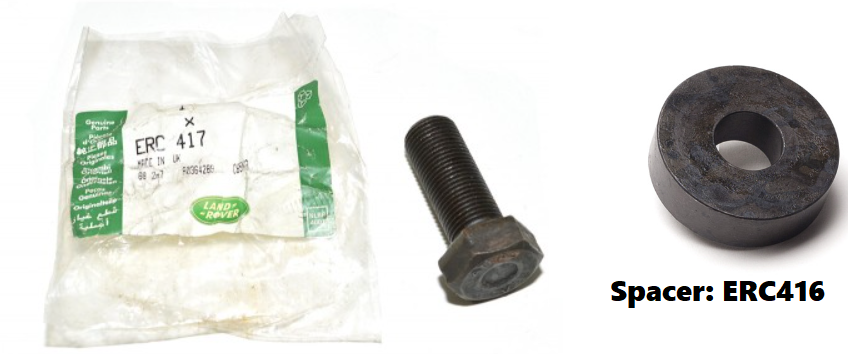

should I reuse the old harmonic damper bolt or get a new one? I sandblasted the old bolt and plan to use the blue loctite, but I read somewhere you should just get a new bolt, I have not seen any new ones for sale on Atlantic british

New, since the threads on the old one have seen a lot of vibration and wobble.

Here are the part numbers for the crankshaft bolt and spacer
Hell YES to the loctite, and please use a torque wrench.

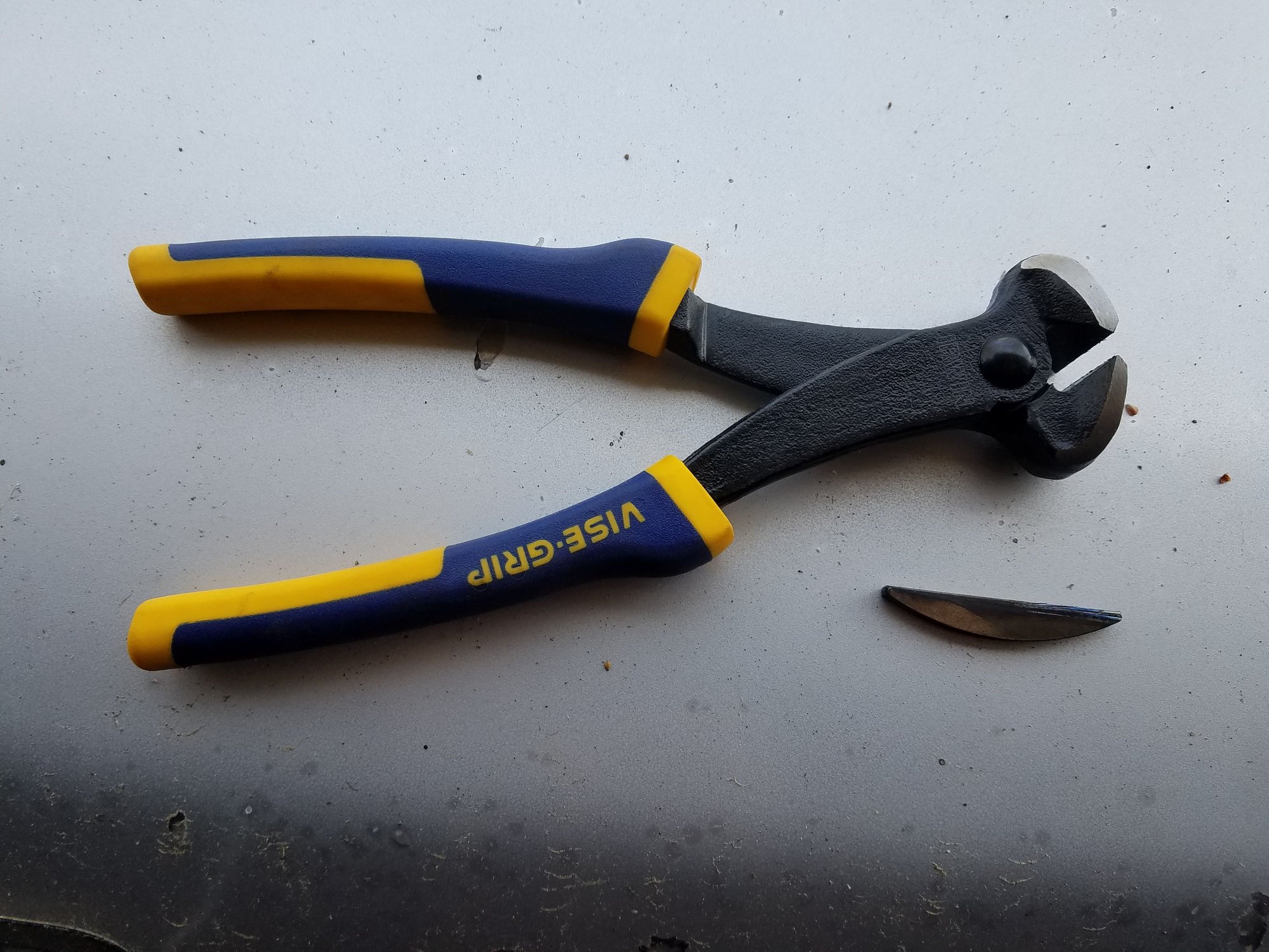

Ok so after removing the crossmember under the oil pan with a sawzall the windshield cracked horizontally across the whole windshield, heated crank sprocket with torch and it came off, but now the woodruff key won't come out, any ideas how to get it out without ruining the crank? I already tried hammer and punch, heating with torch, and prying with a crow bar

I finally removed the woodruff key easily with this tool.
