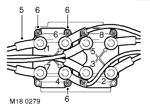

the diagram SuperSport posted in the other thread, do not forget about this!

And putting the new wires back on the coil packs, be sure and keep things quiet, you need to hear the "click, click, click" of the new wire to know it was seated. You'll have to rotate and try to keep the post in the center of the cap while trying to push them on. They are a serious PITA and you'll find yourself exhausted and praying to hear that faint click-click-click on the last couple of plugs! Just make sure you get the sequence correct so you don't have to do it a second time like I did!
