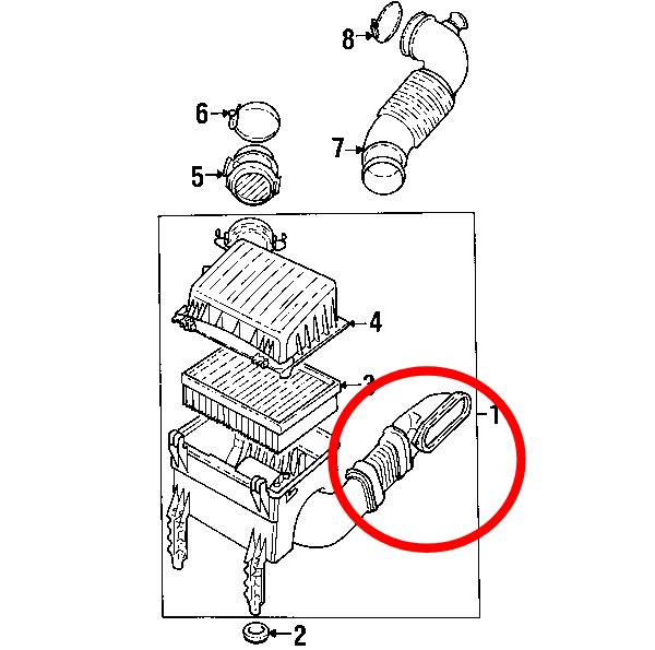

So this piece has worn out and fallen completely apart. Problem is I cannot find it sold by itself, nor can I find what it's called so I can check with used parts guys and junkyards. I can find it on a new intake assembly but would like to avoid $180 spending for just a small part. What is this?!

It’s only sold as the complete air intake box, my custom part coming in 2 months approx.

Your part is going to be just the oval connector piece between fender mount and air box, correct...not whole part that's circled. Just to clarify.

X1 .............. unfortunately Abran is correct and they are sold complete for around $270 so it's worth waiting for Abrans custom made part.

Just the oval tube. You will only need one as it will be made of rubber/plastic and won’t fail like the stock cloth part.

I'm in the same boat. Connector hose is degraded and won't stay connected any longer. Really don't want to buy the whole assembly.

I wonder if you could use a piece of silicon hose, like 4-5" in diameter and then squish it to oval shape? Might work.

X1 ........... if it's only the hose required a piece of large diameter silicon hose would suffice which is easily shaped to suit. It would also look pretty in red, blue or whatever colour

Bingo
