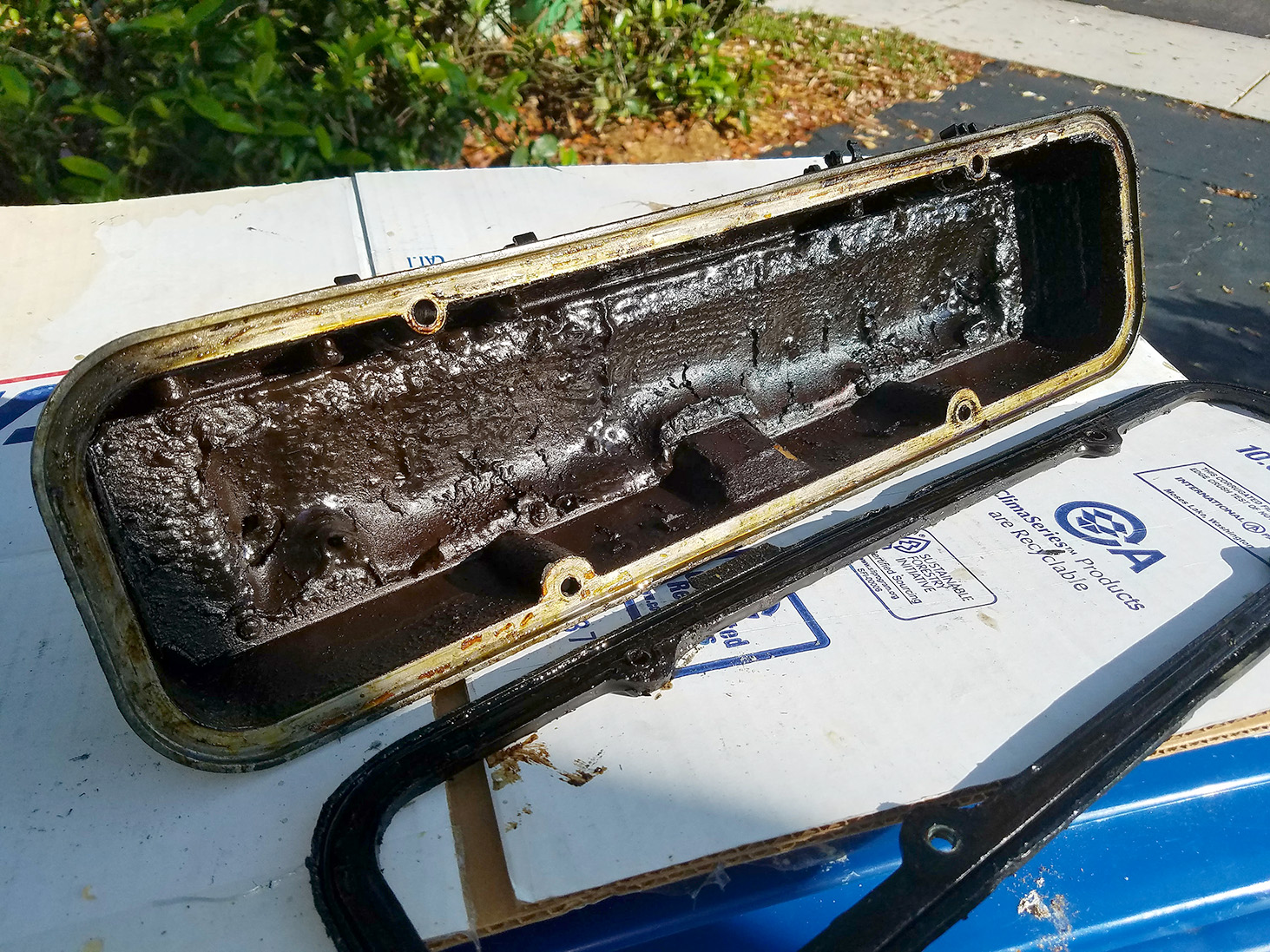

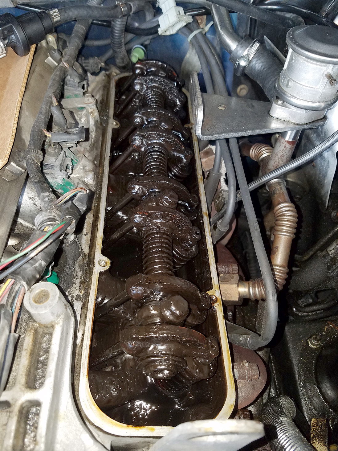

...someone suggested that the housing at the end of the tube, the one that gets bolted into the engine gets removed, and below/inside that there was a "cir-clip" to release, does it make any sense?
...btw, since unable to remove the heater pipe, and looking at my Landy being put out of commission for this upcoming week, I decided to start changing the valve cover gaskets, got the first off -caught my attention that the bolts weren't tight at all, anyways take a look how it looks as soon as they came off!
