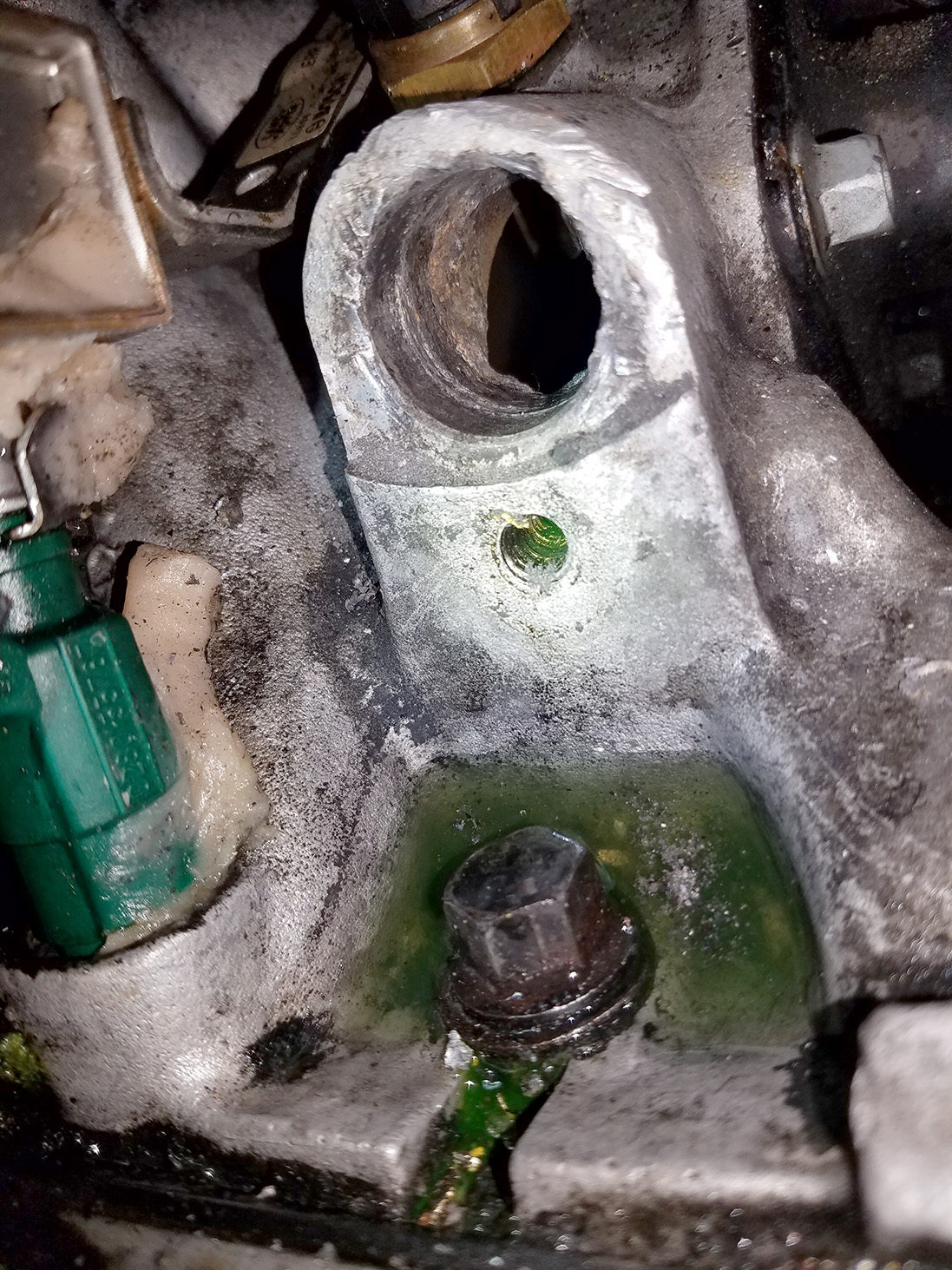

...what you see is the pipe broken off, still the rest remains lodge inside the orifice. I guess besides time, water, coolant and rust making the pipe swell-up against the plenum, the previous owner/s and/or mechanics had to put some kind of sealant to it that sold it tight, sadly that thing wasn't going to come out pulling or pushing.
My AC friend will swing by this weekend to torch and dremmel the remains off with care; cuz even how it is now, it is not easy to chip away what's left.
Once off I'll evaluate the orifice damages, and if necessary to replace the plenum, so as you may see, we're not out of the woods just yet! ;-]#

No progress yet on the "return pipe removal" situation; torch couldn't make it here yesterday, although it should today, as my friend told me; anyways bought a mini hacksaw to try and saw the stuck neck down a bit if need be.

...and out it went! ...heat & determination.
