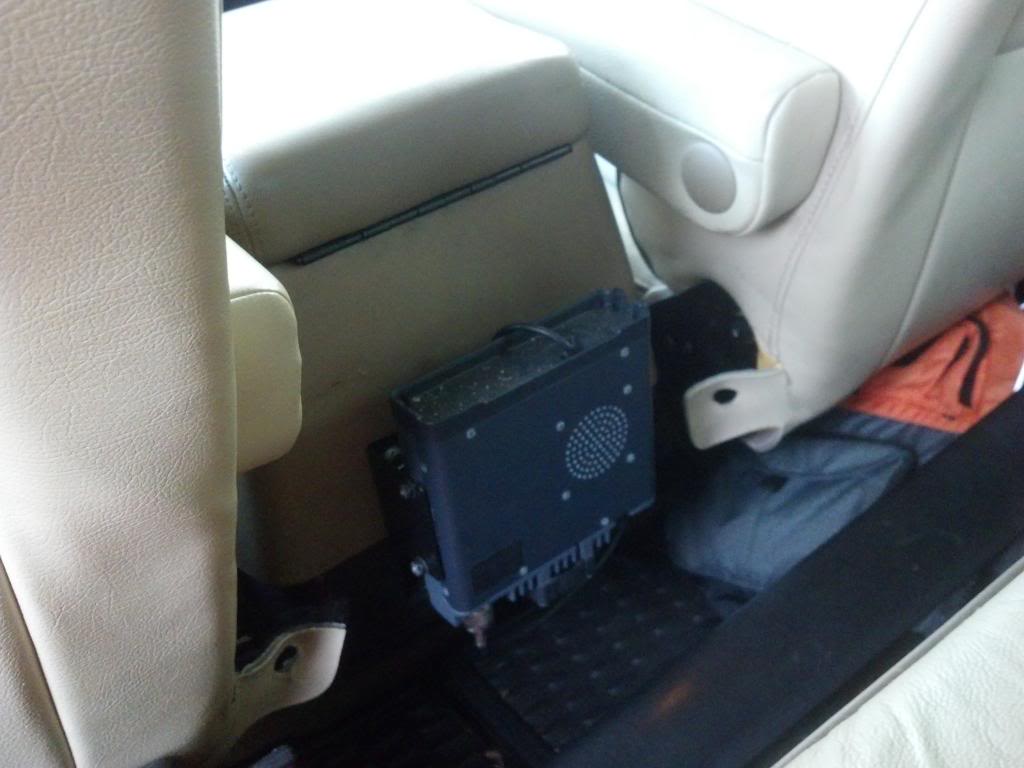

cb I just jammed between the seat and side console, the ham I bolted on the rear of the center console and had the remote headset velcrowed center top above radio... thats a rear view cam thats button controlled so it can be on all the time instead of just while in reverse. the ham radio is direct line to the battery with inline fuses, the cb is direct wired to a "share a circuit" in the engine bay fuse box, the wires all running in a "hide a wire" type plasic ciruclar tube to the port in the firewall. the camera and monitor are connected to the 4 port power toggel u see there thats plugged into the cig lighter. i put the red 3m tape on it but ot doesnt stick anywhere for long, the center consol plastic is too textured as is the back of the cb radio, but it doesnt move there. i have a phone charger, power inverter and the tv plugged into the 4 way toggle. i can run all of them at the same time depending on whats plugged into the inverter obviously, but usually i just have the cb and the camera on. on the dash youll also see my untraguage in the cellphone holder turned sideways (i put it down infront of the center lock ****er if i put the phone there, and on top center is my gopro clip in stickied to the dash (that stayed fine for whatever reason!) and to the left my 10,000mah solar self charging 2amp + 1amp dual USB battery backup for charging whatever has USB lol, awesome device.
