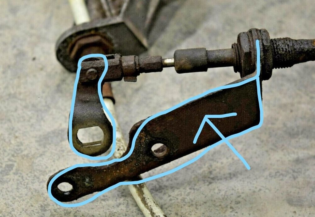

I am missing another part that turns the shifter as well. By looking at the picture.....

The part with the arrow is what I first need, also realized that the other circled part is missing. I need both circled parts. If you know part number and correct name for above parts.

I did mine with a D1 arm, but the equivalent to the small one I just cut out of thick brass. Won't last forever, but it's actually not that much force. And on my 21 year old truck it will probably only be used a dozen times before the inevitable cubing.
