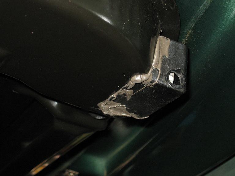

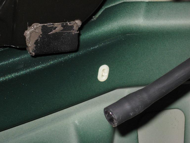

Do the corner connections look something like this?
>>>DiscoMike - are you saying to seal the corner connection with sealant and not reattach the drain tube?
Attached Thumbnails ceiling leak...most likely sunroof?-img_4910.jpg   ceiling leak...most likely sunroof?-img_4907.jpg

it was an actual little box, but we fixed it up with a bunch of silicone so we are going to take mike's advice and leave well enough alone! lol
