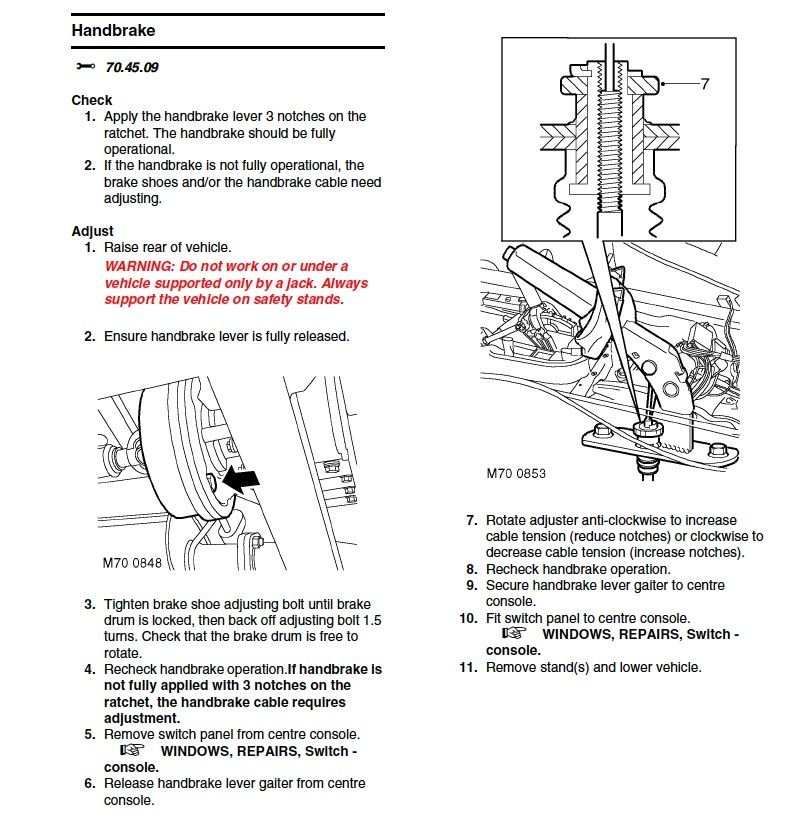

I'm considering dropping the rear driveshaft and locking the CDL to see if the smell persists. I'm also wondering whether it could be the parking brake and the timing is just coincidence. Can anyone give pointers on how tricky it is to access the brake drum?

Looks like I should pull the rear driveshaft anyway, since I'd need to do that to check on the parking brake shoes.

I changed the outer bushings in the Watts arms today. As I was putting the rear wheels back on I discovered that the wheel on one side would spin freely and not rotate the driveshaft, while the wheel on the other side would not spin because I had the parking brake on so the driveshaft couldn't rotate.
Is this a limited slip differential, or is something amiss inside the diff?

So both wheels are off the ground, and you have the P brake on? When you spin one wheel the other should spin in the opposite direction, rather easily. If only one will spin, and the other will not, then yes, sounds like the diff has issues. If the diff is original, it should be open, not LS.

If the parking brake is on and both wheels are off the ground, surely neither should spin? Right?

No, the parking brake only holds the driveshaft, not the wheels like most domestic trucks.
Something isn't right, it's like one of your side gears is completely broken, and the other one is frozen to the carrier (result of the hot smell??). Re the wheel that won't spin, have you confirmed that the brake caliper is not hanging? Regardless, if the parking brake is on, you should not be able to spin one rear wheel and not the other.

I know the parking brake holds the driveshaft and not the wheels. The driveshaft is connected to the wheels via the differential. I don't think I've ever seen a diff where the wheels can coast without the driveshaft rotating (but this is Rover -- all things are possible!)
