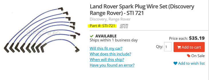

You've probably seen STI, Kingsbourne and Magnacore wires all recommended here. I can't speak to the last two but the STIs on my truck have performed well for probably nine years and probably 70,000 miles (I don't have my maintenance file here to validate those numbers but I believe them to be close).
Old Jul 12, 2017 | 10:02 AM
OverRover's Avatar
Posts: 2,514
Likes: 656
I'm with you 100% on STI wires! I've used these for many years (RRC, DI,& DII) with zero issues. And I've hade too many failures with Kingsbourne (& not just on Rovers). Not a fan of that junk!
STI> https://www.fcpeuro.com/products/lan...e-rover-hls103
