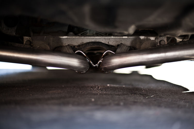

It's "tight" under your truck....? Here's a photo of my S60R's exhaust split.
It rubs when there's a big enough crown in the road.... Working under the Disco is a prize.
