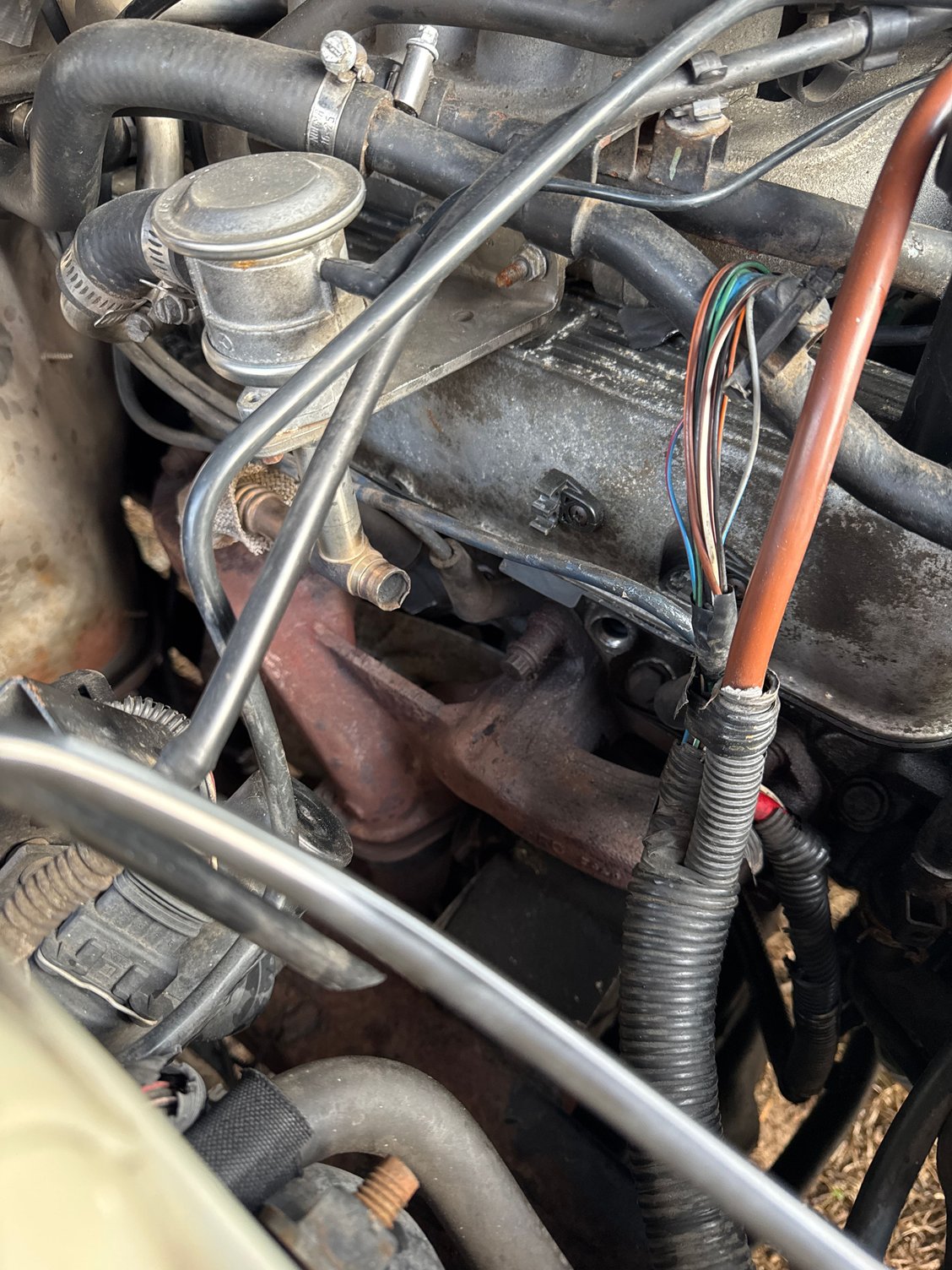

Well, as it turns out I was chasing the wrong thing.
I have the SAI plumbing and I had broken the flex aluminum from the little filter to the block when I replaced the valve cover gaskets. I rigged a heater hose for a temporary fix. It finally gave out. I didn’t see it before because the crack was just too small.
So, new question. This SAI assembly appears to be a single piece. Has anyone else fashioned a replacement for just part of it?

@fowlerjk04 Yea the SAI tubes are hard to find. There are few afte market ones that are better
