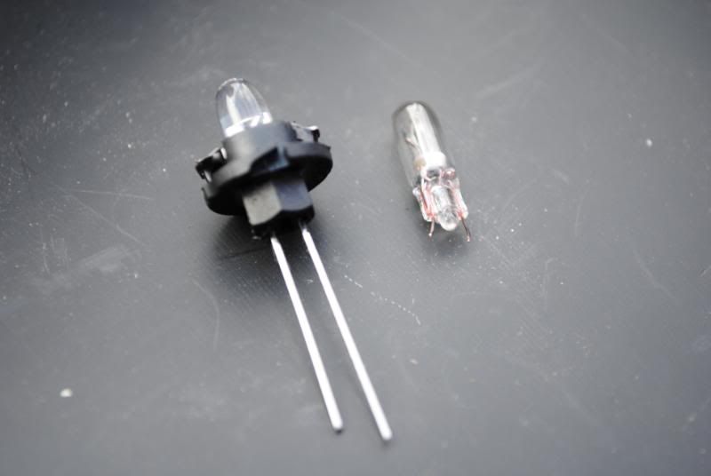

Put an LED in it and forget about it.
What size and color LED is that?

Likes: 45
Radio shack
Lamp assemblies, Miniature bulbs & lamps, Hobby & Do-It-Yourself | RadioShack
I would strive to put an LED in there.
To put in an LED - you may need to put a resistor in series.
The LED will have a max current rating of so many ma's milliamps and this rating must be respected.
E=I*R
R = E/I
If E is 13.8 volts and I is .022 (for 22 ma)
R = 13.8 / .022
630 OHM resistor
Color code on resistors is
B B R O Y G B V G
1 2 3 4 5 6 7 8 9
Green Violet Brown I think..
Ah well here is a guide
http://www.google.com/url?sa=t&rct=j...55123115,d.cGE

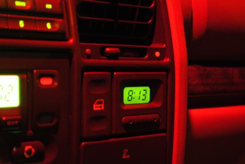

I can't get the clock out.
Where to put the two thin credit cards under?
And how far back?
I have green LEDs and a resistor and am ready to install
An LED
Old Oct 24, 2013 | 06:48 PM
  #25
jalodge's Avatar
Joined: Sep 2013
Posts: 318
From: Charleston, SC
You push the cards above the clock/central lock assembly. They go pretty far back and it takes some wiggling around. It will eventually start to slide out and you can pull in out from there.

YES I did get that clock out.
Many many thanks.
I just put in a little 1.2w Orsam bulb.
I did not make the LED bulb with the resistor.
The clock - is a bear to get out.
You need two credit cards but a bit thinner and you need to wedge them in
bending the clock frame a bit and the dash plastic.
And you need to convince the clock to slide out with a thin screwdriver.
The lamp is not soldered in. Just a typical dash lamp which is put in by turning it counter clockwise 1/2 a turn and the lamp pops out.
Once done the clock pops back in easy.

I was going to try the LED in hopes of not having to replace it again but I don't want to go through the trouble of making a circuit with a resistor. Did Street Wolf use a resistor in his?
