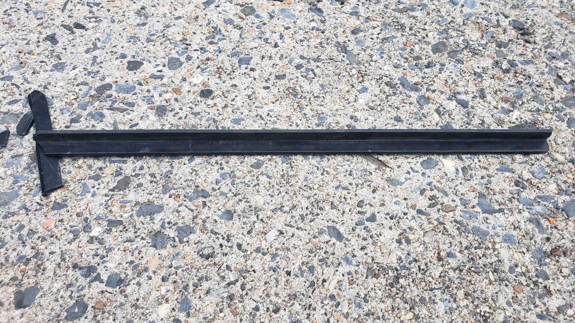

I turned the car on to test some other stuff and it made a coffee grinder noise then spat pieces of plastic out from under the car. Took the upper shroud off and found this between the fan and the radiator.
Doesn't appear to be any damage to the radiator, but I feel like this might have been useful for something. Any idea what this was?
EDIT: Per the RAVE manual, it appears it may have been the sealing strip from the bottom of the radiator. I have no idea how it got where it ended up.

That looks like part of the lower shroud. Heck most of em are broken by now anyways. As long as you have the 4 screws securing the upper to the radiator, and the back two secured to the lower shroud you'll be fine.
Yep I truly believe the Nissens unit and the generic unit roll down the exact same assembly line. I've seen way to many auto parts go by the name Gates, AC Delco, GMB, and a few others only to find the only difference in the part = the box it came in or the name on the box. The part itself is identical with the same exact markings or place or origin.
Well that's a relief (note to self: find the missing two quarter-turn fasteners from the upper shroud).

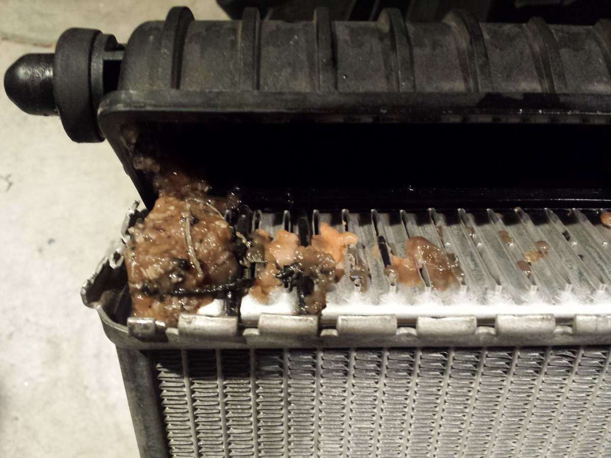

Originally Posted by Discorama
I got constantly 210F at red lights, now it is around 190F. I found some sludge in my radiator, blocking about 20% of the lower channels (one of the POs probably added green coolant to the red, which is said to produce some gel in the coolant). But this wasn't the only culprit. A new thermostat (180F), a new fan (old one's viscous clutch didn't engage anymore) and extensive flushing brought the temp down, I did all step by step. It brought the temps down step by step, there wasn't a single cure.
Can you explain how you got the side tanks off? I'm assuming it's easier to clean the sludge out that way.

You just pry the aluminum retainer off the end tanks. In my experience the tanks "spring" when removed from the radiator and the sealing edges bow in. Almost impossible to get them back in the correct shape and sealing once off, takes lots of blocking and heat on the tanks, and silicone for sealing. Still might start leaking at some point. I have also started just throwing them away and going with the ebay radiators, no difference to the Nissens that I can see.

If you flush it in the truck(engine running), you will be dislodging some of the sludge in the radiator, which then can get stuck and gum up somewhere else, like the heater core(flush the heater core both directions with a garden hose regardless)
I'de save the hassle and just buy a new one.
