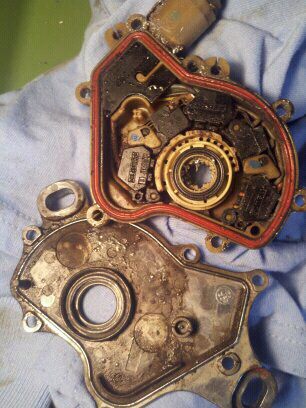

I actually found that the transmission was in Reverse when I crawled under to look at the XYZ switch again. I must have accidentally moved the spline but it still started.. So I disconnected sprayed contact cleaner in both plugs waited to dry and re-connected the switch... Now nothing, turn the key and nothing. the dash lights all lighting up the same, M&S and the "drive" with a line through it...
Code reader is still flaging the P0705 "A" Circuit and now P1668 which the best I can find is Anti theft, I am guessing that is the super lockdown of the tranny and engine...
I will keep looking... Maybe cracking the XYZ switch open and sraying contact cleaner and air drying for the night may do something , I dont know now!! LOL!!!

I think that your best bet (in my opinion) is to get a used XYZ switch off of ebay. I know it's hard to spend money when you are not sure if it will fix your problem, but without a scanner like TestBook, Hawkeye, or Nanocom you are limited to the testing and diagnosing you can do. The Code 0705 is all you have to work on and that points to the XYZ as your issue.
Mud and water inside XYZ,

I have been reading other post that have had this code and most got this code after getting stuck in mud or going through high water. The A/C also drains right on top of the switch so it is fairly common for them to fail.
Use some electronic cleaner spray and air to clean the inside the XYZ switch and nothing else.

When I pulled the XYZ switch out there was no water or mud damage noted, it looked completely dry inside, almost brand new.. A little dust but nothing that looked bad.. all the contacts were shinning and bright looking so I assumed that everything had to been in order so I put it back together using the one link I found on here using bolts and silicone.
This morning when I tried to start it, the Right Blinker was blinking and the turn signal lever was not pushed up to Right, it was in the center position.
I checked the Grounds on the Alt again and all seems good. Checked the Battery Ground and again all good. I just pulled the XYZ switch out again and am going to open it up and spray cleaner in it and let it sit in the sun to dry out??? Maybe that will work???
