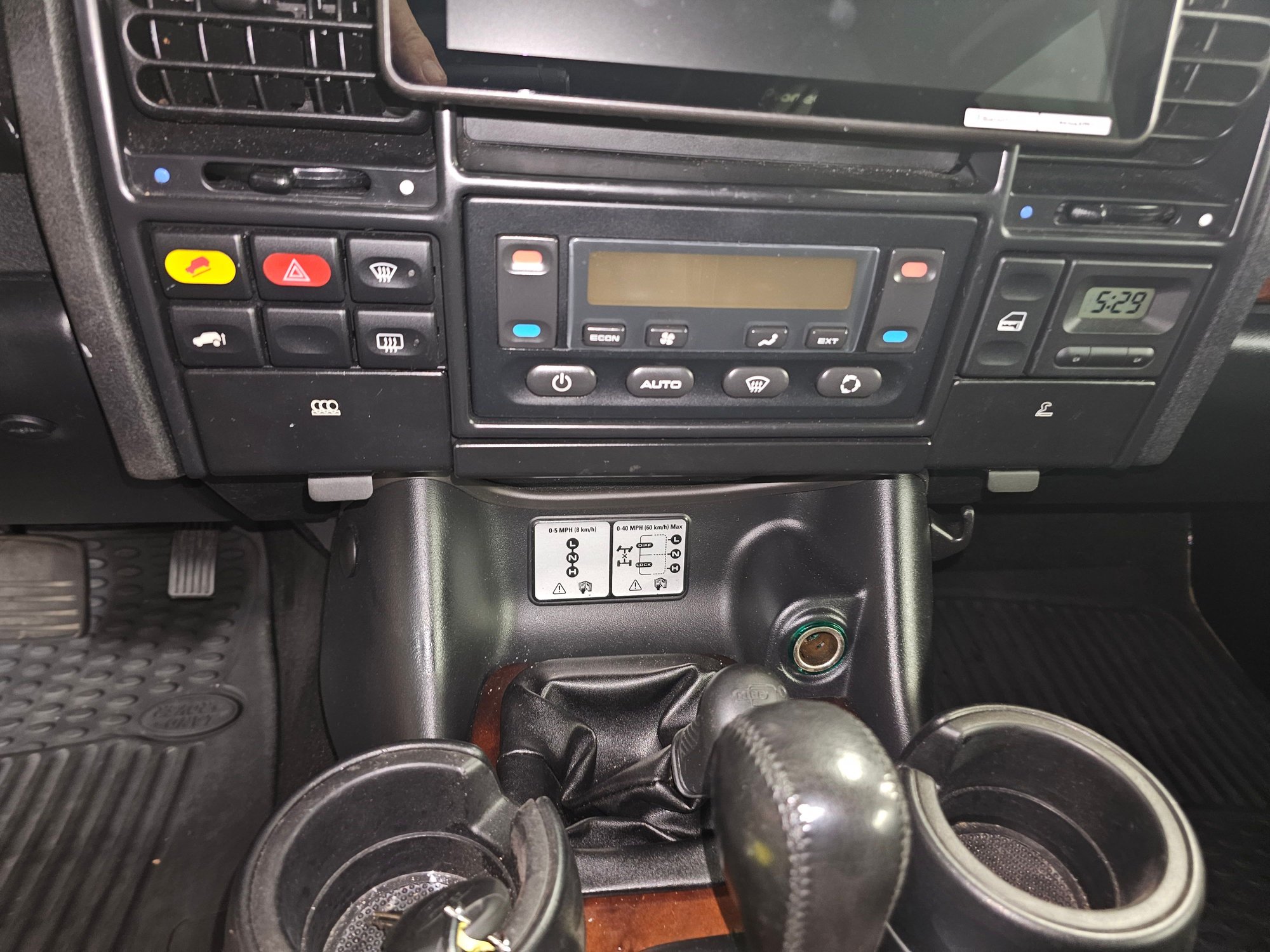

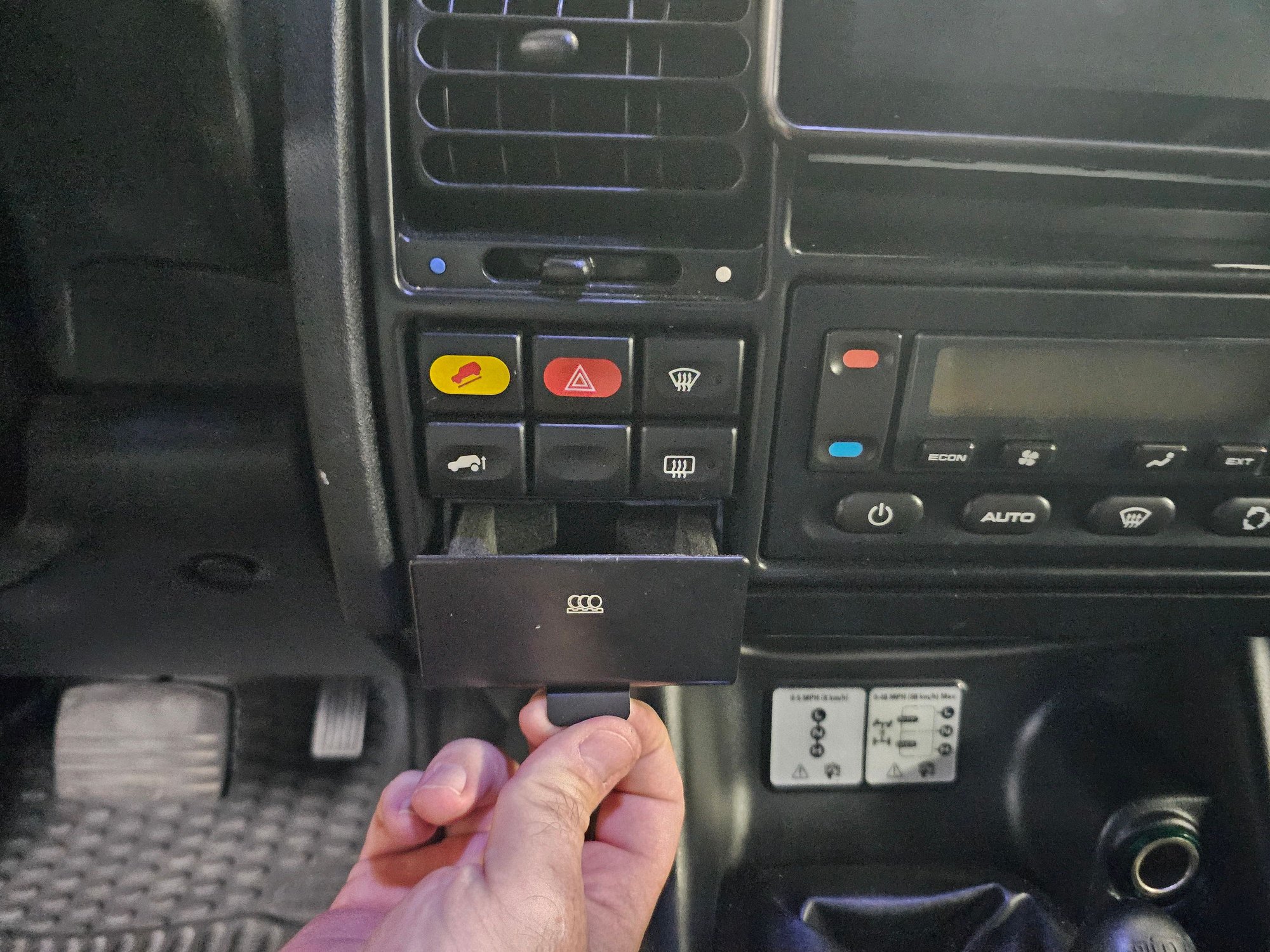

Hey all.

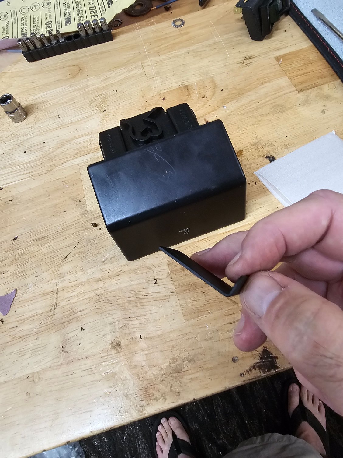

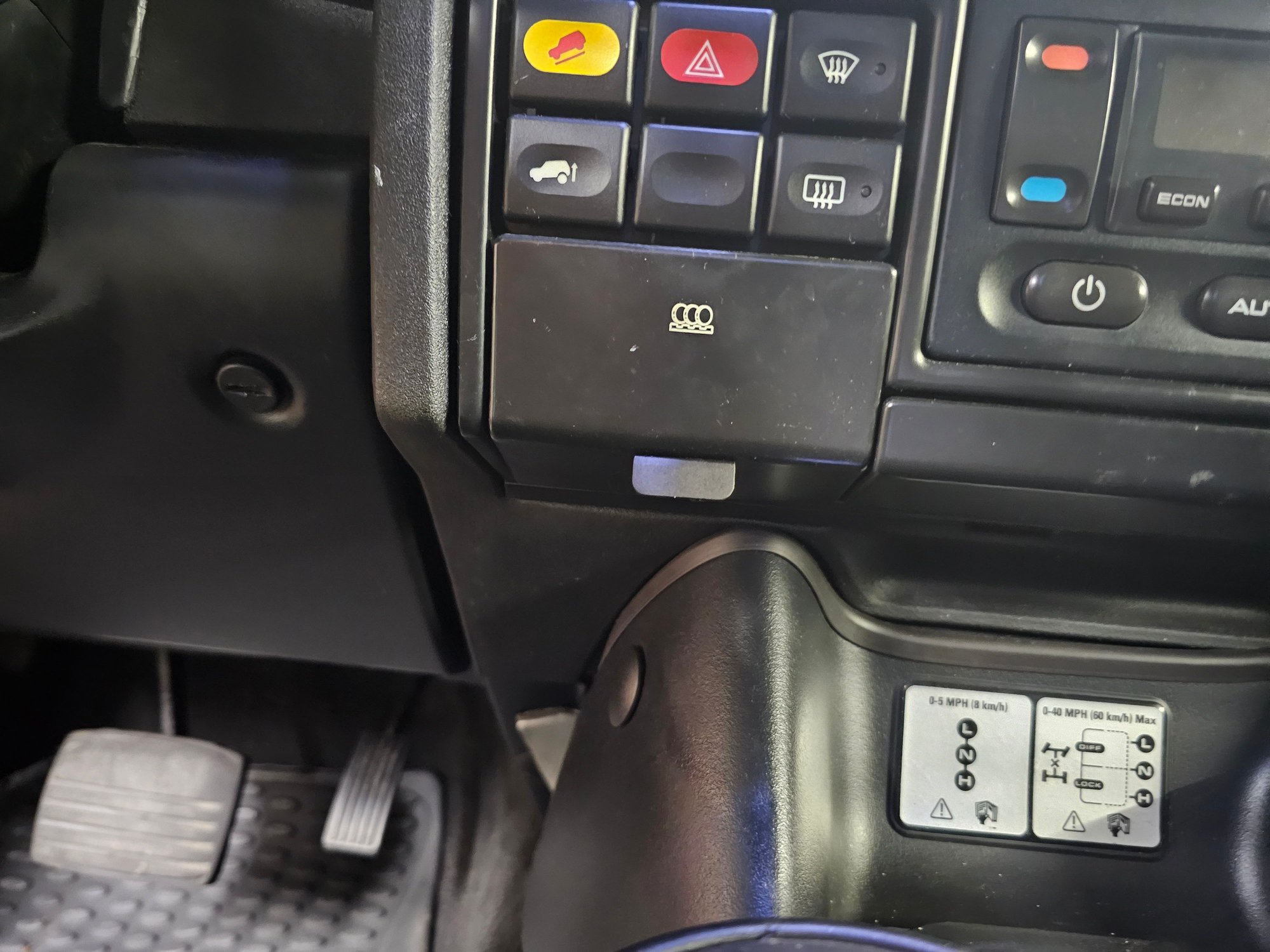

I thought I'd pass along an easy mod for the two drawers on the dash. Mine were stuck fully pushed in and when I took it apart the small spring arm was broken. That arm attaches to the dash and I didn't want to take the whole dash apart to fix the draw.
So i found these small cabinet pull tabs and attached them the the drawers works great.
THE model and site where to order is in the pics.
