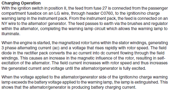

I spent some quality time this summer replacing the alternator in my truck and found this description of how the battery light works in the RAVE. Sounds like the alternator in your truck may not be getting excited fast enough. Counseling or some other therapy may be needed.
