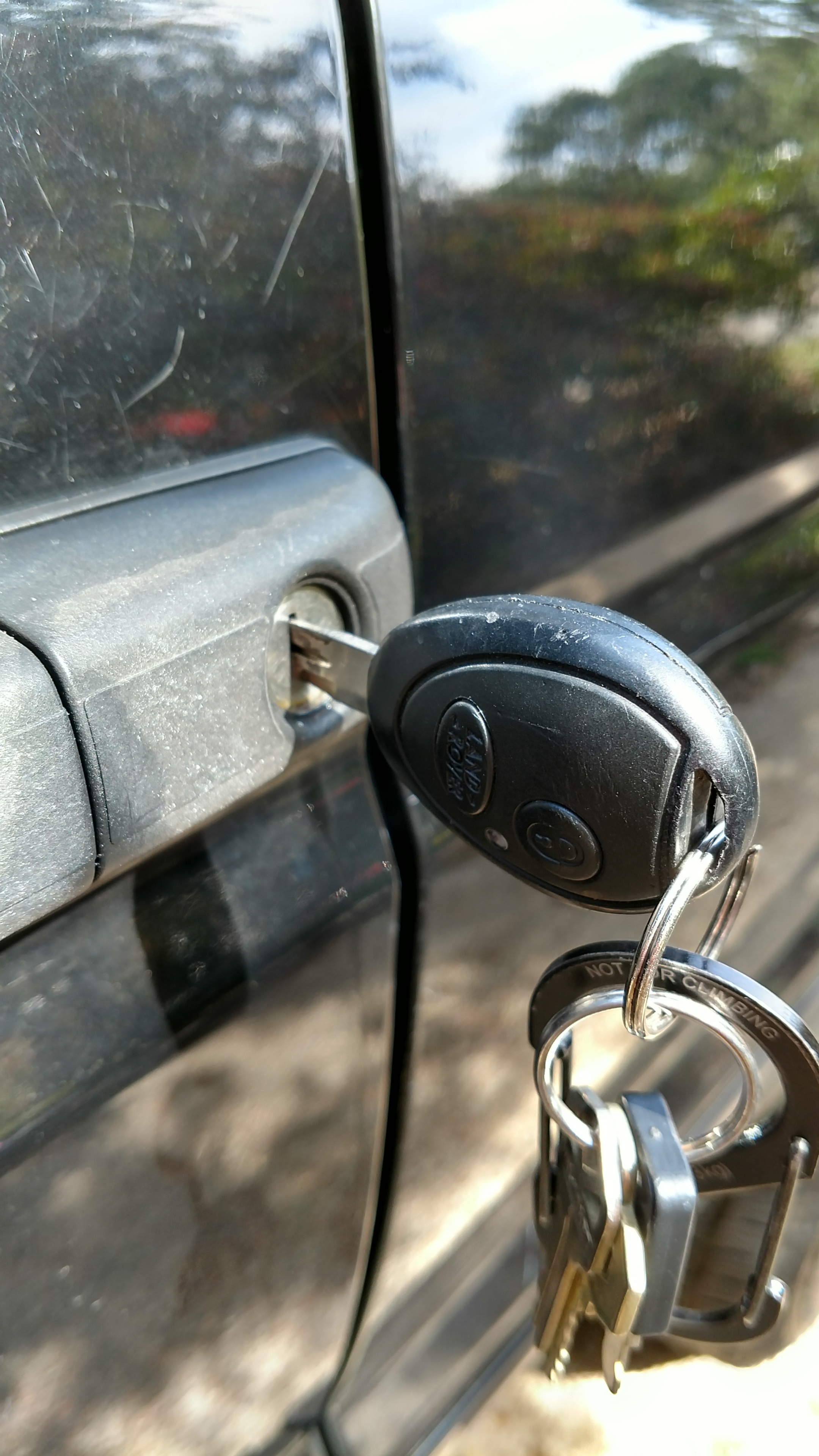

Yep I have tried the spare key that is practically new but not programmed. It won't turn either.
Part of me thinks the key isn't going in far enough (again I don't think I've ever actually unlocked it manually before so excuse me for this one). It wiggles quite a bit but won't turn more than a few degrees.

here's a rundown on what happened so hopefully you folks will still be interested in helping me out.
- last night locked the truck with the hood open while connected to battery charger
- went to unlock first thing this morning and nothing happened when I pressed the button
- battery charger indicated full battery
- *battery terminals are old and dont get tight enough but I highly doubt they decided to fly off this morning when I closed the hood. Never had connection issues
- disconnected charger and closed the hood, turn signals flashed
- nothing happens when I press lock or unlock on the FOB besides the FOB's LED flashing (brand new battery in FOB)
- red LED on dash flashing as if superlocked (I dont know why else it would be flashing)
- key will not turn more than a couple degrees in door lock. Appears to not be going in all the way. I can't imagine it could be forced in any farther.
If I open the hood through the grill will the alarm definitely sound and will disconnecting the battery turn it off? The fob doesnt seem to be capable of anything.
If I get under the hood could disconnecting the battery reset the alarm? Shouldn't my fob work no matter what sort of thing is going on?
From searching around I feel like I'm in the situation where my battery has died or disconnected while the truck was superlocked.. but the red dash LED is flashing.
