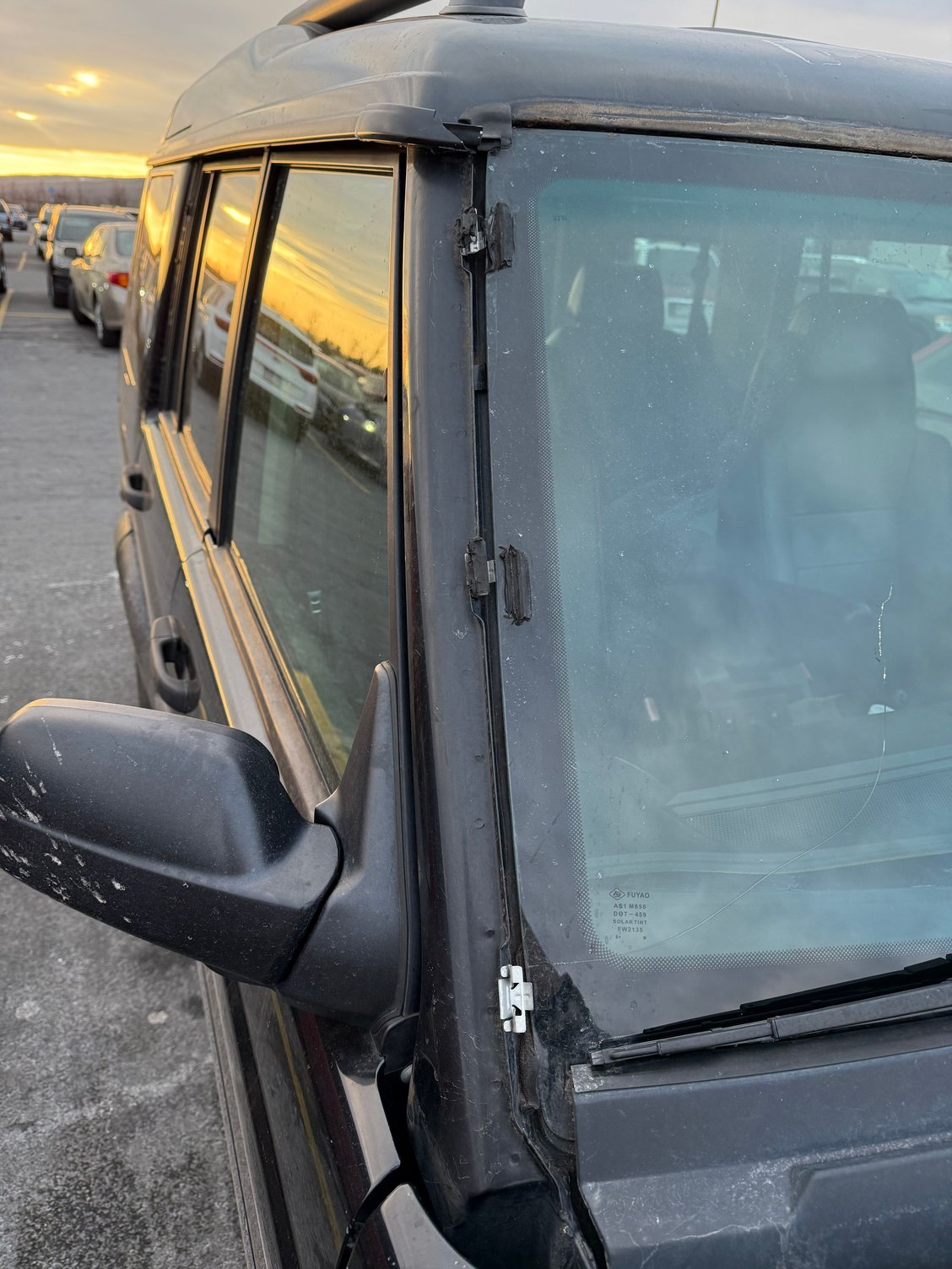

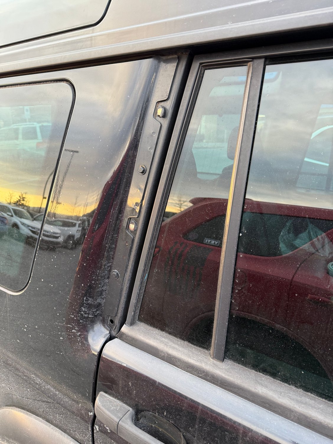

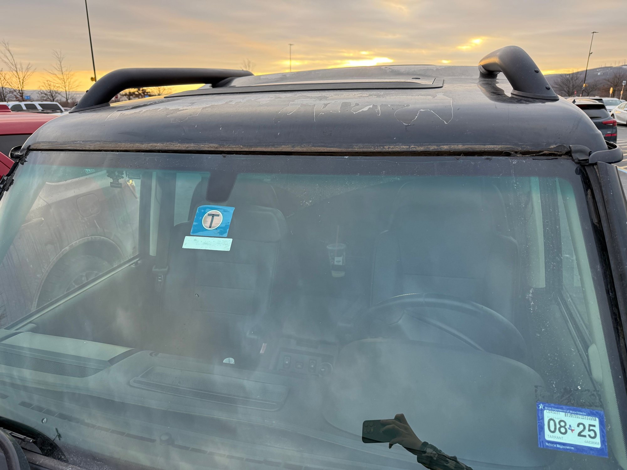

Over the last month or so my disco has been flying apart (literally). Parts have gone flying off while driving down the highway, most recently the upper windshield rubber starting flapping off. I tried to place it back but no luck. I had to pull over and remove it entirely. I'm not sure why this is happening, but maybe its something to do with it sitting out in Texas sun and heat for 4 years before I got it.
I've tried to compile a list of the parts needed, and surprisingly, I've found them for sale OEM on Landrovers parts site (parts.jaguarlandroverclassic.com). I wanted to check to confirm I've got all the right parts for my 2004 Discovery 2 so I don't get any disappointment and make any unintended purchases while money is tight.
Here are a few pics of the issues:
Parts in order of images:
DCB101510 - Land Rover Finisher assembly-windscreen:
£108. Very expensive bit of rubber!!!
DAR100790 - Land Rover Decal-A post blackout / DAR100780 - Land Rover Decal-A post blackout (L+R)
£23 Each since other side is loose.
​​​​​​​DAR500110PMA - Land Rover Label - D Post / DAR500100PMA - Land Rover Label - D Post (L+R)
£10.50 Each, one side off completely, other side loose.
​​​​​​​If these parts are all right, are these the best prices I can get? It's pretty cheap, with exception of the Finisher assembly-windscreen. I'm also thinking about getting the windshield replaced, would that include the replacement of that part, as that cost is half of the windshield!!
Let me know if you have any suggestions or notice anything I might be missing.

The plastic finishers would not be replaced typically when you have a company replace the windshield. The trim behind the rear door requires you to remove the interior trim to get at the bolts that secures it. You can get aftermarket replacements that are cheaper. Not sure about the part numbers listed.
