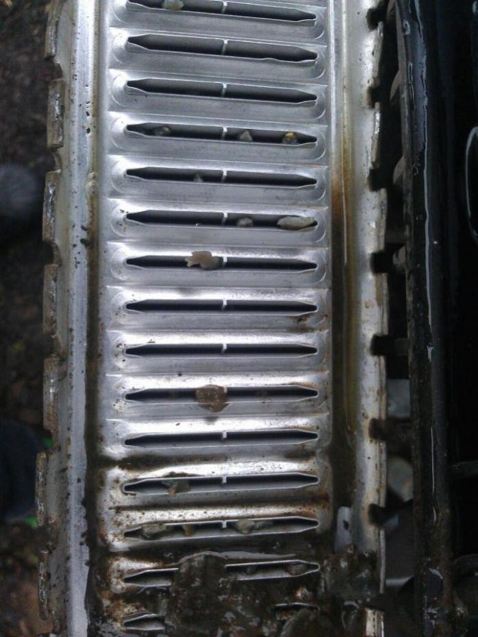

The Dexcool, if not changed frequently, or if exposed to air, or if contaminated with other coolants (top up by the Iffy Lube oil shop) changes into a "mud" in the lower rows of radiator, and can decompose the coolant cap as well. One way to eval radiator is to warm up truck, cut engine, and use an IR thermometer to "see" the temp of the radiator fins top to bottom. If lower rows are 10F cooler, then something is restricting their flow. Pix on left is a Rover rad with normal coolant buildup from lack of change, little parts of calcium from use of non-distilled water, etc. Dexmud has mud plus the chunks.
Most people don't flush coolant every two years and use a chemical flush when doing it. And the LR3 gang gets told to leave it in there 10 years or 150,000 (which is fine with Robin Bastid down at the repair shop, warranty is long over by then).
