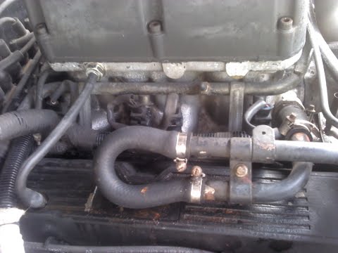

On a D2, the heat gauge sensor is the ECU. The ECU reads the coolant sensor, uses that to work all kinds of magic, and also sends a signal to the gauge to stay at 9:00 unless too cold or too hot. Basically stay put so no one will complain. A more accurate way of looking at it is your code reader / scanner, where you can see the digital temp that ECU sees.
On a D2 hot water goes thru heater core whenever truck is running, there is no cut off valve.
That said, look over the attached flow chart for the plumbing. Notice that hot coolant goes down the top leg of the three legged thermostat, it goes toward water pump on the "arm" leg of the stat. Cooled coolant enters from the lower radiator hose. The top of the stat has small sampling holes in it that allow a little hot water to flow into the stat, warm it up, and cause it to open. This should happen starting at 180F, and fully open at 204F.
Sometimes the stats are bad and don't open (after market). Sometimes those little holes get full of gunk on a rad flush or major engine work.
Now you might have a blocked heater core (thanks to Dexcool), you could test by back flushing the heater core pipes (messy). You can also have a large air bubble in the system that is making part of the cooling system a steam room, instead of the hot bath it should be.
A lot of people struggle with refill of the D2, and some get better results by unbolting and raising the coolant recovery bottle. You basically have to make a mess, coolant needs to be coming out bleeder screw constantly, not in spurts. I wish they had a T with a stub you could attach a hose to and drain into a bucket with engine running to circulate the bubbles.
If line under coolant tank is kinked that can cause problems. If any of the small hoses are kinked, that can cause a problem. And some owners have found their heat core bypassed.
