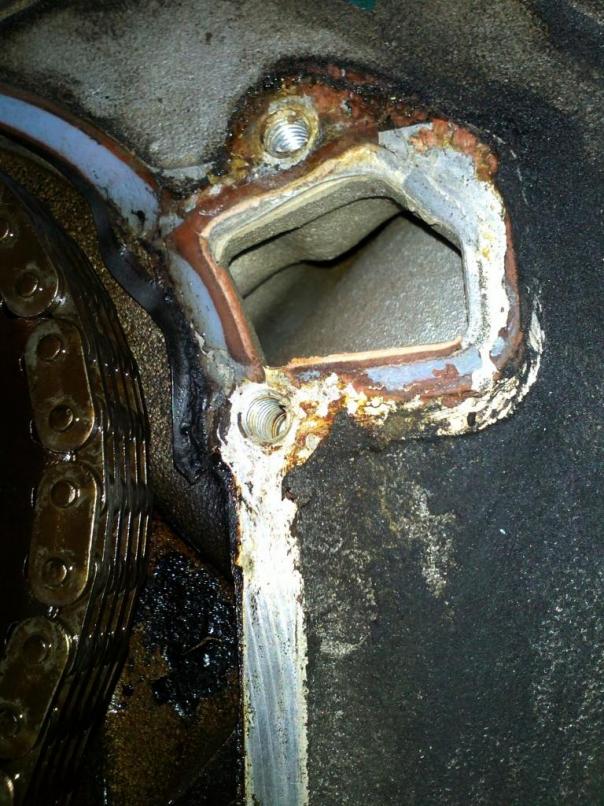

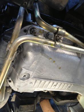

I finally cleaned my engine enough to locate this coolant leak. Does this appear to be the common timing cover leak? As far as I can tell, the arrow points to the highest point of the leak.

About $110 in parts. You would want to change the oil pump while you have it open. Check timing chain, if sloppy change that also. Would not want to drag this out because water can leak into the oil also on this gasket.
